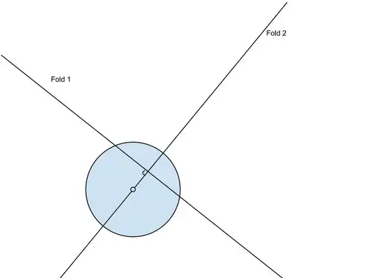

This construction uses the fact that perpendicular bisector of a chord goes through the center of the circle.[See picture]
First, fold the paper so the crease forms a chord across the circle. Now, crease the paper at the points where the chord intersects the circle. Then, fold the paper perpendicular to the chord, so the two creases overlap. Unfold, and you should see that the new crease is the perpendicular bisector to the chord, and thus goes through the center of the circle.
Repeat with another chord. The intersection of the two perpendicular bisectors will be the origin.
