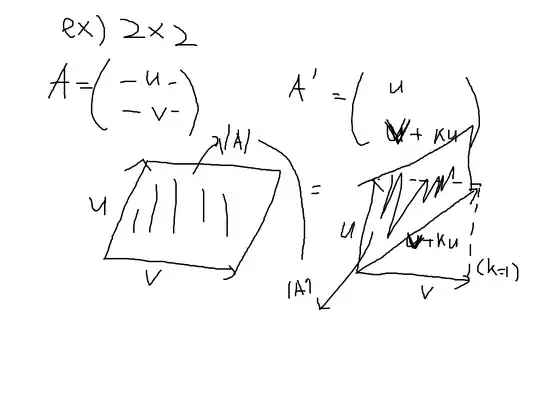

A multiple of any row can be added to another, this kind of row elementary operation does not change the determinant value. The picture below illustrates an intuitive understanding of that, too.
Math
Writing the sides of the parallelogram as rows or columns of a square matrix, this transformation transforms it to another with the same value of the determinant.

  • The image shows the 2x2 determinant as the area of the parallelogram formed by the two vectors. – Momo Nov 14 '16 at 18:00
  • yeah the image shows the the operation (Add a row to another one multiplied by a number) conserve the "determinant" value – jotkey Nov 14 '16 at 18:01
