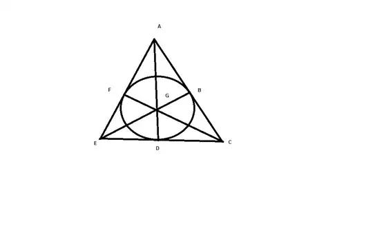

Here is a simplified version of your problem with the geometrical diagram.
It might be phrased like, how many committees of 3 can be formed by a group of 7 people such that no pair of people serve on two committees.
The figure is called the "Fano Plane" and a finite protective plane.
Your figure will be several orders of magnitude more complicated, but a similar idea.

  • "the Fano plane is the finite projective plane of order 2, having the smallest possible number of points and lines, 7 each, with 3 points on every line and 3 lines through every point." Another clear description for me.. Then to solve such a question I have to draw such things? – Ahmed Amir Nov 02 '16 at 17:27
    Each "line" (the circle in the middle counts as a line) represents one of your dice. In the Fano plane these are 3 sided dice, you will need a more complicated figure with 6 points on each line. The letters are the equivalents of the numbers on the faces. So, you need a figure with 25 intersecting curves, six points on each curve, and no more than 31 points of intersection. – Doug M Nov 02 '16 at 17:56
