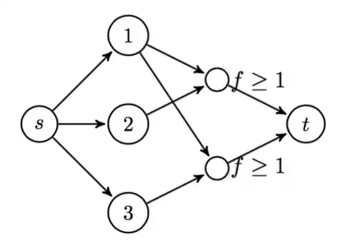

Actually, this is not a difficult problem, it can be solved efficiently by interpreting it as a network flow problem. Suppose you have the following problem: $$ \min \; x_1+x_2+x_3 $$ subject to $$ x_1+x_2 \ge 1\\ x_1+x_3 \ge 1 \\ x_1,x_2,x_3 \in \{0,1\} $$
Now, create the following graph:enter image description here
Add a unitary cost on arcs $(s,1), (s,2), (s,3)$, and impose that the flow $f$ on all arcs ending in node $t$ is at least equal to $1$. Use any minimum cost flow algorithm to solve the problem and you are done.
EDIT $1$: There is a contradiction between this answer and @hardmath's answer: one of the two is not possible. The problem cannot be NP-hard and be solved in polynomial time. I suspect there is something wrong with my flow model, but I cannot figure out why. Ahuja and Magnanti (Networks Flows) have proposed shortest path algorithms for this problem if there are consecutive 1's in the columns of the matrix, but not for the general case. This is a hint that I believe something must be wrong with my flow model for the general case. Below is their network flow model if there are consecutive 1's in the columns of the matrix. See their book for more details.
EDIT $2$:
As @Erwin Kalvelagen pointed out, the above network flow model is wrong. The reason for that is that the inflow in node $s$ does not equal the objective function (the number of active variables). It counts the total number of times each variable is used, which is not what we want.

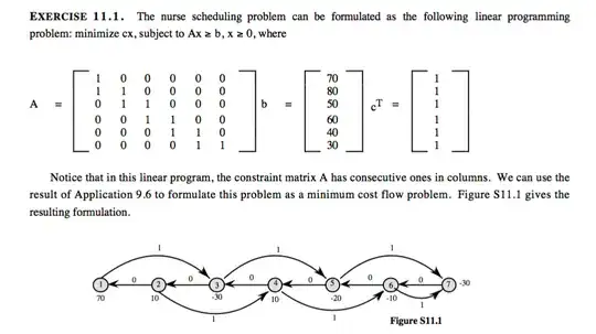

    • if your set covering problem has a particular type of structure, specifically, if all $1's$ are consecutive in the matrix columns, then the problem is no longer NP-hard and you can use the approach described above in Ahuja and Magnanti's book.

    I am not sure this network correctly implements the set covering problem. I guess the outflow at t is the number of sets (equations, i.e. 2). What is the inflow at s? A variable inflow indicating the number of active variables? That would be 1. – Erwin Kalvelagen Oct 31 '16 at 03:39
  • @ErwinKalvelagen: Yes exactly, the inflow at $s$ would be the number of active variables, i.e. $1$ here (variable $x_1$). – Kuifje Oct 31 '16 at 13:06
    So where is this extra flow coming from? One in at s and two out at t. – Erwin Kalvelagen Oct 31 '16 at 13:08
    You are absolutely right. This is where the problem comes from. This network flow model does not minimize the number of active variables. Thank you Erwin for finding the error here. Your expertise is definitely valuable. – Kuifje Oct 31 '16 at 13:22

    The consecutive one's case results in a totally unimodular matrix, and the LP optimal BFS is thus integral. When the matrix isn't totally unimodular, you can end up with fractional optimal solutions. I belief that's where Kuifje's argument breaks down. – Brian Borchers Oct 30 '16 at 17:51
