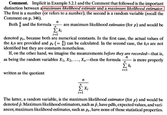

Hint: Assuming $\theta_e = y_{\max}$ (a number), we have
$\hat{\theta} = Y_{\max}$ (random)

However (lol), I'm not sure $\theta_e = y_{\max}$. How did you get that? I got the same pdf for $Y$'s as you, but...
...the likelihood I got is
$$L(\theta) = \prod_{i=1}^{n} \left[\frac{1}{\sigma \sqrt{2 \pi}} \exp\left(\frac{-(y_i-\theta x_i)^2}{2\sigma^2}\right)\right]$$
Maximising $L(\theta)$ is equivalent to maximising $\ln L(\theta)$ so when I did the latter, I got
$$\theta_e = \frac{\sum y_i x_i}{\sum x_i^2}$$
$$\to \hat{\theta} = \frac{\sum Y_i x_i}{\sum x_i^2}$$

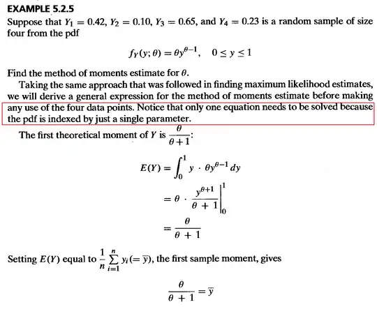

For b:
What's $X$?
What I got was that
$$0 = E[Y_i] \stackrel{set}{=} \frac{y_1 + \cdots + y_n}{n}$$
$$\to \theta_e = \frac{-\sum e_i}{\sum x_i}$$
$$\to \hat{\theta} = \frac{-\sum E_i}{\sum x_i}$$
$$\to Var(\hat{\theta}) = \frac{n\sigma^2}{(\sum x_i)^2}$$
Here my $e$'s are numbers and $E$'s are random. In your notation, $e$'s are random.
I don't think we need to compute $E[Y_i^2]$ anymore (which is $\sigma^2$, not $0$) because there's only one parameter to estimate:
