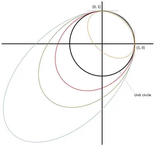

I'm trying to find a parameterised affine transform that will transform the unit circle into the family of ellipses shown.
The unit circle passes through (0,1) and (1,0) and is tangential to the lines (1,x) and (x,1). In this question, the circle is transformed into an ellipse that retains those properties. Because the properties only fix 4 parameters and a unique ellipse requires 5, there will be a family of ellipses, defined by a single parameter "p" ("p" being arbitrary within some range), which all share these same 4 properties with the unit circle.
Since a transform from a unit circle to an ellipse (however rotated or translated) is affine, I'd expect to be able to represent the transform from the unit circle to a member of this family of ellipses in this kind of form:
x -> A.x + B.y + C
y -> D.x + E.y + F
where A,B,C,D,E,F are functions of "p".
(It isn't important what "p" actually represents, so long as it parameterises the family of ellipses.)
I'm having difficulty getting a suitable transform for this.
The approach I tried was to look at what happens to 3 easy points under the required transform: (0,1) and (1,0) stay fixed at (0,1) and (1,0), and (0,0) must be mapped due to symmetry, to some other point on the diagonal (Z, Z) where Z < 1/sqrt(2) and Z will often be negative. This gives 6 trivial equations in 6 variables, and as there should be just one solution for any given value of the parameter this should be it.
But when I do this, I get an ellipse that isn't tangential to the 2 lines, I think that's because the lines that the ellipse I get is tangent to at the fixed points, have also been transformed and are no longer horizontal/vertical.
Has my approach inadvertently loosened up the parameters so that I'm getting multiple families? If not, then what's going on, and what do I have to do to fix it?

Rotate the figure by $45°$ to align on the coordinate axis and dilate by $\sqrt2$ for convenience.
The ellipse equation turns to
$$a^2(x-p)^2+b^2y^2=1$$ where $a^2,b^2$ and the inverse of the squared axes lengths and $p$ the position of vertical axis.
The slopes are given by
$$a^2(x-p)+byy'=0.$$
Express that the ellipse passes through $(1,\pm1)$ with slope $\mp1$:
$$a^2(1-p)^2+b^2=1,$$ $$a^2(1-p)-b^2=0.$$ (By symmetry, the other two equations are identical.)
You can solve the $2\times2$ linear system for $a^2$ and $b^2$ as functions of $p$, and you obtain the affine transform
$$(x,y)\to(a(p)(x-p),b(p)y).$$
Compose with the reverse scaling by $\sqrt2$ and the counter-rotation by $45°$ to get the final answer.
Something like $$(x,y)\to\left(\frac{(a(p)(x-p)-b(p)y}2,\frac{a(p)(x-p)+b(p)y}2\right).$$

Mistake with your approach
Although your transformations should preserve the tangency conditions, this does not mean that the points of tangency are fixed points. In fact they can not be. Think about it this way: if you have two points and the tangent directions in these points, then these uniquely define the point where the tangents intersect. If all of this is to remain fixed, you have three fixed points and the only affine transformation with three non-collinear fixed points is the identity. Ergo your points of tangency can't be fixed.
Family of conics
So what's your family of conics? You already know one such conic, namely the unit circle:
$$x^2+y^2-1=0$$
Another one is the degenerate ellipse of zero minor semiaxis which passes through the two points of tangency:
$$(x+y-1)^2=x^2+y^2-2x-2y+2xy+1=0$$
The family of conics (or pencil of conics) would be the set of all linear combinations of these two. Introducing a parameter $p$ you could write them as
$$(x^2+y^2-1)+2p(x+y-xy-1)=0$$
or something like that.

Your assumption that the two tangent points of the circle will remain fixed is leading you astray, as you’ve discovered. As MvG explains in his answer, the only affine transformation that leaves these points fixed and maps the lines $x=1$ and $y=1$ to themselves is the identity. Instead, we’ll build up the transformation in stages. It will consist of a dilation, a 45° rotation and a translation.
To make the calculations simpler, consider an ellipse in standard position. We want its normal at the point in the first quadrant with $y=1/\sqrt2$ to be parallel to the line $x=y$. From this condition, we get $${x\over a^2}=\frac1{\sqrt2b^2}\quad\text{and}\quad{x^2\over a^2}+{1\over2b^2}=1.$$ Combining these two equations gives a relationship between the major and minor axes of the ellipse: $$a^2=b^2(2b^2-1).$$ Solving for $b$ looks a bit messy, so we’ll take it (the semi-minor axis length) as our parameter. (Note that we must have $b\gt1/\sqrt2$ for an ellipse.) We thus get the dilation matrix $$S=\begin{bmatrix}b\sqrt{2b^2-1}&0&0\\0&b&0\\0&0&1\end{bmatrix}.$$ Next, we compute the required translation. For our point of interest to end up at $(0,1)$ after rotation, we must translate it to $(1/\sqrt2,1/\sqrt2)$, which can be accomplished by translating by $$\frac1{\sqrt2}-\frac1{\sqrt2}{a^2\over b^2} = \sqrt2(1-b^2)$$ along the $x$-axis. Alternatively, we can translate last, in which case the translation will be along the line $x=y$, giving the translation matrix $$T=\begin{bmatrix}1&0&1-b^2\\0&1&1-b^2\\0&0&1\end{bmatrix}.$$
The rotation matrix is, of course, $$R=\begin{bmatrix}\frac1{\sqrt2}&-\frac1{\sqrt2}&0\\\frac1{\sqrt2}&\frac1{\sqrt2}&0\\0&0&1\end{bmatrix}.$$ Composing these three transformations produces the required family of affine transformations: $$M=TRS=\begin{bmatrix}b\sqrt{b^2-\frac12}&-\frac1{\sqrt2}b&1-b^2\\b\sqrt{b^2-\frac12}&\frac1{\sqrt2}b&1-b^2\\0&0&1\end{bmatrix}.$$ If we take $p=2b^2-1$, this becomes $$\begin{bmatrix}-\frac12\sqrt{p(1+p)}&-\frac12\sqrt{1+p}&\frac12(1-p) \\ -\frac12\sqrt{p(1+p)}&\frac12\sqrt{1+p}&\frac12(1-p) \\ 0&0&1\end{bmatrix}$$ for $p>0$, which is a perhaps more aesthetically pleasing range.
