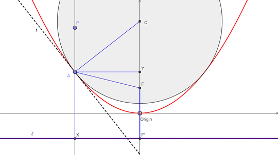

Show that a ping-pong ball with radius $r$, lying inside a wine glass described by the function $x^2$, has its center at $r^2+\frac{1}{4}$ units above the bottom of the glass.
Here is a visualization of the problem 1
My best attempt is trying to find the derivative of the circle and the function to find some relationship at the point where they meet. The problem looked very simple at first, but I can't figure it out now.

We can prove this result by invoking the geometrical properties of a parabola, with resort to minimal calculation. Specifically, I will use two well known properties:
  1. Any point on a parabola is equidistant from its focus and directrix. (Follows from the definition of parabola.)
  2. Let $A$ lie on a parabola with focus $F$ and directrix $\ell$. Then the tangent to the parabola at $A$ bisects $\angle FAA'$,where $A'$ is the projection of $A$ on $\ell$. (Well-known, see this page at cut-the-knot for a proof.)
Diagram showing locations of points/lines referred to in proof Now suppose $C$ is the center of the circle (the ping-pong ball) and $A$ is the point where it touches the parabola in the 2nd quadrant. Now let $X,Y$ be the projections of $A$ onto $\ell$ (the directrix of the parabola) and the axis of the parabola respectively. Also, let $F$ be the focus of the parabola. From the parabola $y=x^2$, we'll just take the fact that $FF'=\frac12$ and that $O$ bisects $FF'$, and then forget the axes.
Now let $AX=x$, then from property $1$, $AF=x$. Also, the dashed line $t$, the tangent to $\odot(C)$ and the parabola at $A$, bisects $\angle FAX$ (property $2$), and is perpendicular to the radius $AC$, so $AC$ is the external bisector of $\angle FAX$. (Note that this also follows from the optical property of parabola.) Therefore $\angle FAC=\angle PAC=\angle ACF$ (since $AP||CF$)$\implies FC=FA=x$.
Now we are ready to begin the few computations. $FY=YF'-FF'=AX-FF'=x-\frac12$, $CY=CF-FY=x-\left(x-\frac12\right)=\frac12$. Now from Pythagoras' theorem, $$\begin{align*}AY^2=&AF^2-FY^2=AC^2-CY^2\\ \implies & AC^2-CY^2=AF^2-FY^2\\ \implies &r^2-\left(\frac12\right)^2=x^2-\left(x-\frac12\right)^2\\ \implies &r^2=x.\end{align*}$$
Therefore the desired distance $CO=CF+FO=x+\frac14=r^2+\frac14$. $\blacksquare$

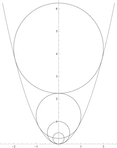

13
The point on a parabola is $\left(x,x^2\right)$, the normal at this point has direction $(-2x,1)$. That is, the normal is parametrized by $$ \left(x-2xt,x^2+t\right) $$ The point on the axis of the parabola ($x=0$) is at $t=\frac12$: $$ \left(0,x^2+\tfrac12\right) $$ The distance from $\left(0,x^2+\tfrac12\right)$ to $\left(x,x^2\right)$ is $r=\sqrt{x^2+\frac14}$ . This is the radius of a ball that would be tangent to the parabola at $\left(x,x^2\right)$. The center of this ball would be at $$ \left(0,r^2+\tfrac14\right) $$ as long as $r\ge\frac12$. When $r\lt\frac12$, then $x=\sqrt{r^2-\frac14}$ is not real. Then the ball sits on the bottom of the glass; its center at $$ (0,r) $$ Here is a plot of the glass and balls of radius $\left\{\frac14,\frac12,1,2\right\}$:
