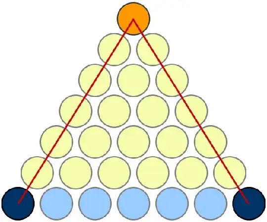

Thanks to Vaughn Climenhaga and Mariano Suárez-Alvarez, I give you the interesting summation and picture
$$\underbrace{\sum_{k_1=1}^r\sum_{k_2=1}^{k_1}\sum_{k_3=1}^{k_2}\dots\sum_{k_{n-1}=1}^{k_{n-2}}\sum_{k_n=1}^{k_{n-1}}}_n1=\frac{(r+n-1)!}{n!(r-1)!}\tag1$$
visual proof for $n=2$:
example usage:
