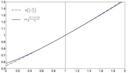

What is interesting, it appears numerically that:
$$\ln \left( \frac{e-e^x}{1-x} \right) \leq \sqrt{\frac{1+x+x^2}{3}}, \qquad 0<x \leq 1$$
$$\ln \left( \frac{e-e^x}{1-x} \right) \geq \sqrt{\frac{1+x+x^2}{3}}, \qquad x \geq 1$$
How would you prove both of these inequalities?
Around $1$ both functions are very close. See the plot below:
This is related to my recent question.
The series expansion doesn't seem to be the best way.
