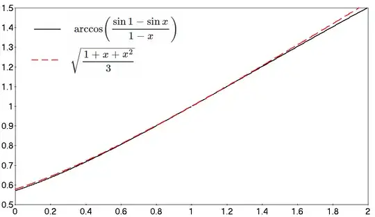

But then I've noticed that for $0<x<1$ the following two functions are very close (see the picture):
Now how would you prove:
$$\arccos \left( \frac{\sin 1-\sin x}{1-x} \right) \leq \sqrt{\frac{1+x+x^2}{3}}$$

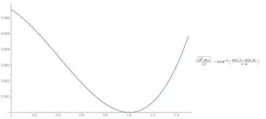

Just to confirm (numerically) that the inequality holds, here is the plot of the difference between the two functions:
Yuriy S
  • 32,728
  • If I'm reading it correctly, the graph you have seems to suggest that $\arccos\left(\frac{\sin(1) - \sin x)}{1-x}\right) \ge \sqrt{\frac{1+x+x^2}{4}}$. Is this the inequality you want to show? Or is the graph mislabeled? (Or am I missing something?) –  Aug 25 '16 at 15:50
  • @Strants, I mislabeled it, yes. Thank you! – Yuriy S Aug 25 '16 at 15:56
    @xpaul, I plotted every mean I know for $x$ and $1$ and then plotted even more means. – Yuriy S Aug 25 '16 at 16:07

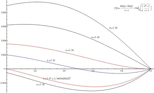

Geometric Explanation “Why $3$ ?”
(Not an Answer)
In order to explain why the inequality could be true, we have: $$ x^3-1=(x-1)(1+x+x^2) \Rightarrow \cos\sqrt{\frac{1+x+x^2}{3}}=\cos\sqrt{\frac{1}{\color{red}{3}}\frac{x^{\color{red}{3}}-1}{x-1}} $$ And by considering the general case $\space x^n-1=(x-1)(1+x+x^2+\cdots+x^{n-1})$, Let: $$ \begin{align} & \color{red}{f_{\alpha}(x)} = \frac{\sin(1)-\sin(x)}{1-x}-\cos\sqrt{\frac{1}{\color{red}{\alpha}}\frac{x^{\color{red}{\alpha}}-1}{x-1}} \quad\colon\space \alpha \ge 1, \space \alpha \in \mathbb{R} \\[2mm] & \qquad \Rightarrow \space f_{\alpha}(0) = \lim_{x\rightarrow0}f_{\alpha}(x) = \sin(1)-\cos\left(1/\sqrt{\alpha}\right) \\ & \qquad \rightarrow \space \text{for}\space f_{\alpha}(0)=0 \Rightarrow \alpha=1/\arccos^2\left(\sin(1)\right) \\[2mm] & \qquad \space\&\space\space \space f_{\alpha}(1)= \lim_{x\rightarrow1}f_{\alpha}(x) = 0 \quad \left\{\text{for all}\space\alpha\right\} \\ & \quad\qquad\qquad\qquad\qquad\qquad\qquad\qquad\qquad\qquad\qquad\qquad\qquad\qquad\qquad\qquad\qquad\qquad\qquad\qquad\color{white}{\text{.}} \end{align} $$ Also: $$ \begin{align} & \color{red}{f'_{\alpha}(x)} = \small \frac{\sin(1)-\sin(x)-(1-x)\cos(x)}{(1-x)^2}-\frac{1-x^\alpha-\alpha(1-x)x^{\alpha-1}}{2\alpha(1-x)^2}\sqrt{{\alpha}\frac{x-1}{x^\alpha-1}}\,\sin\sqrt{\frac{1}{\alpha}\frac{x^\alpha-1}{x-1}} \\[2mm] & \qquad \Rightarrow \space f'_{\alpha}(0) = \lim_{x\rightarrow0}f'_{\alpha}(x) = \sin(1)-1+\frac{1}{\sqrt{\alpha}}\,\sin\left(1/\sqrt{\alpha}\right) \\[2mm] & \qquad \space\&\space\space \space f'_{\alpha}(1)= \lim_{x\rightarrow1}f'_{\alpha}(x) = \color{red}{\frac{\sin(1)}{4}\,(\alpha-3)} \\ & \quad\qquad\qquad\qquad\qquad\qquad\qquad\qquad\qquad\qquad\qquad\qquad\qquad\qquad\qquad\qquad\qquad\qquad\qquad\qquad\color{white}{\text{.}} \end{align} $$ enter image description here
By swiping $\alpha$ from $1$ towards $\infty$, considering the range $x\in[0,1]$:
${\bf1}$. Starting by $\space f_1(x)=\left[\sin(1)-\sin(x)\right]/[1-x]-\cos(1)$, a well defined function,
$\qquad$ smooth decreasing curve from $(0,\sin1-\cos1)$ to $(1,0)$, no $x$ axis intersection (no zeros).
${\bf2}$. Smooth adjustment in the decreasing behavior while $\alpha$ increases.
${\bf3}$. At a certain value $1\lt\alpha_0\lt1/\arccos^2\left(\sin(1)\right)$, $f_{\alpha}(x)$ will stop being completely decreasing,
$\qquad$ start to have an increasing part, causing intersection(s) with $x$ axis (at least one zero).
${\bf4}$. Between $\alpha_0\lt\alpha\lt1/\arccos^2\left(\sin(1)\right)$, $f_{\alpha}(x)$ surly has at least one zero.
${\bf5}$. For $\alpha\gt1/\arccos^2\left(\sin(1)\right)\Rightarrow f_{\alpha}(0)\lt0$,
$\qquad$ and the function should stop intersecting with $x$ axis.
${\bf6}$. When $\alpha\rightarrow\infty\space\Rightarrow(x^\alpha-1)/(x-1)\approx1/(1-x) \Rightarrow f_{\alpha}(x)\approx1\frac{\sin(1)-\sin(x)}{1-x}-\cos\left(\frac{1/\alpha}{1-x}\right)$.
And from the definition of $f'_{\alpha}(x)$, we can calculate the value of $\alpha_0$ that stops the completely decreasing behavior and create a horizontal tangent at the end of the interval $x\in[0,1]$: $$ f'_{\alpha_0}(1)=0 \space\Rightarrow\space \frac{\sin(1)}{4}\left(\alpha_0-3\right)=0 \space\Rightarrow\space \color{red}{\alpha_0=3} $$ The inequality is really interesting because it shows the maximum $\alpha$ of $\left\{f_{\alpha}(x)\ge0\colon x\in[0,1]\right\}$
As-well-as, for $\left\{3\lt\alpha\lt1/\arccos^2\left(\sin(1)\right)\right\}$ we have $\left\{f_{\alpha}(0)>0 \space\&\space f'_{\alpha}(1)>0\right\}$, Thus:
The function $f_{\alpha}(x)$ have an odd number of zeros in the range $x\in[0,1]$.
In fact, if we can argue to replace the statement "at least one zero" with "at most one zero" for $3\lt\alpha\lt1/\arccos^2\left(\sin(1)\right)$, then the equality is proved!

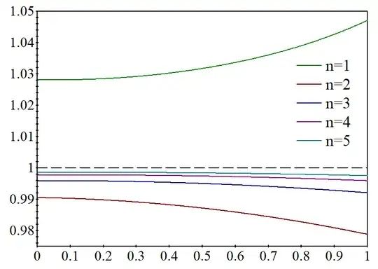

It makes sense to try infinite products, mainly because we get rid of the square root:
$$\text{sinc}(t)=\prod_{n=1}^\infty \left(1-\frac{t^2}{\pi^2 n^2} \right)$$
$$\cos (t)=\prod_{n=1}^\infty \left(1-\frac{t^2}{\pi^2 (n-1/2)^2} \right)$$
Thus, our inequality becomes:
$$\prod_{n=1}^\infty \left(1-\frac{(1-x)^2}{4\pi^2 n^2} \right) \left(1-\frac{(1+x)^2}{4\pi^2 (n-1/2)^2} \right) \geq \prod_{n=1}^\infty \left(1-\frac{1+x+x^2}{3\pi^2 (n-1/2)^2} \right)$$
Note that for $x<1$ every term in the infinite products is positive.
If, for example, every term of the product on the left is greater than every term of the product on the right, then our inequality is proven.
$$\left(1-\frac{(1-x)^2}{4\pi^2 n^2} \right) \left(1-\frac{(1+x)^2}{4\pi^2 (n-1/2)^2} \right) \geq^? 1-\frac{1+x+x^2}{3\pi^2 (n-1/2)^2}$$
After expanding and simplifying I obtained the following:
$$-\left(4 \pi^2 n(2n-3)+3(\pi^2-(1+x)^2) \right)(1-x)^2 \geq^? 0$$
And this is highly questionable, i.e. not correct for most cases. Remember, we are interested in the case $x < 1$, so:
$$4 \pi^2 n(2n-3)+3(\pi^2-(1+x)^2) \leq^? 0$$
$$4 \pi^2 n(2n-3)+3\pi^2 \leq^? 3 (1+x)^2$$
For $n=1$ we have a trivial inequality:
$$-\pi^2 < 3 (1+x)^2$$
But for $n \geq 2$ the inequality quickly stops working.

I decided to rearrange the second product so the terms are of the same order in $x$ and $n$:
$$\prod_{n=1}^\infty \left(1-\frac{1+x+x^2}{3\pi^2 (n-1/2)^2} \right)=\prod_{k=1}^\infty \left(1-\frac{1+x+x^2}{3\pi^2 (2k-3/2)^2} \right) \left(1-\frac{1+x+x^2}{3\pi^2 (2k-1/2)^2} \right)$$
Still, we have the same relation: only the first terms of the products obey the inequality, while all the rest seem to break it.
Below you can see the plot for:
$$ \dfrac{\left(1-\frac{(1-x)^2}{4\pi^2 n^2} \right) \left(1-\frac{(1+x)^2}{4\pi^2 (n-1/2)^2} \right) }{ \left(1-\frac{1+x+x^2}{3\pi^2 (2n-3/2)^2} \right) \left(1-\frac{1+x+x^2}{3\pi^2 (2n-1/2)^2} \right) }$$
For $x \in [0,1]$ and $n=1,2,3, \dots$.
I see no way to prove that the product of all terms for $n \geq 2$ is still closer to $1$ than the first term (despite numerical evidence), so this way doesn't seem to work as a proof of the original inequality.
