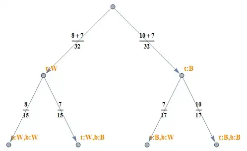

When shuffling and flipping at random, each of the following 32 configurations is equally likely: $$ 8: (W,W), \quad 7: (W,B), \quad 7:(B,W), \quad 10:(B,B) $$ where the first letter denotes the color of the top side of the card, and the second denotes the color of the bottom side. The top of the first card is black in $10+7$ cases out of $32$. Thus, for b), the probability is $\frac{17}{32}$. Out of these $17$ cards, $7$ will have white bottom side, and $10$ will have black bottom side. Continuing in this manner produces the following tree diagram:
Now answers to remaining questions can be easily read off from this diagram.
