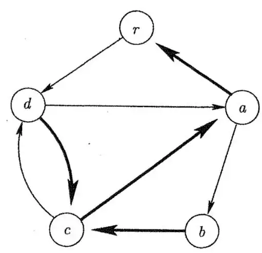

How do we find Euler path for directed graphs? I don't seem to get the algorithm below!
Algorithm
To find the Euclidean cycle in a digraph (enumerate the edges in the cycle), using a greedy process,
Preprocess the graph and make and in-tree with root $r$, compute $G¯$ (reverse all edges). Then perform Breadth first search to get the tree $T$. This is $O(|E|+|V|)$. enter image description here
When we perform the algorithm, we'll get the list,
$r\to d\to a\to b\to c\to d\to c\to a\to r$
