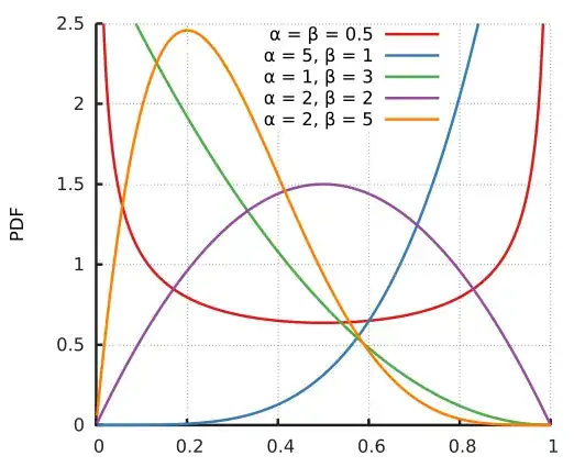

One way to think about this is by thinking of the probability $p$ of the coin landing heads to be a random variable. We can assume that we know absolutely nothing about the coin to start with, and take the distribution for $p$ to be a uniform random variable over $[0,1]$. Then, after flipping the coin some number of times and collecting data, we change our distribution accordingly.
There is actually a distribution which does exactly this, called the Beta Distribution, which is a continuous distribution with probability density function $$f(x) = \frac{x^{\alpha-1}(1-x)^{\beta-1}}{B(\alpha,\beta)}$$ where $\alpha-1$ represents the number of heads we've recorded and $\beta-1$ the number of tails. The number $B(\alpha,\beta)$ is just a constant to normalize $f$ (however, it is actually equal to $\frac{\Gamma(\alpha)\Gamma(\beta)}{\Gamma(\alpha+\beta)}$).
The following graphic (from the wikipedia article) shows how $f$ changes with difference choices of $\alpha,\beta$:
PDF of Beta Distribution for different parameters
As $\alpha \to \infty$ (i.e. you continue getting more heads) and $\beta$ stays constant (below I chose $\beta=5$), this will become extremely skewed in favor of $p$ being close to $1$.

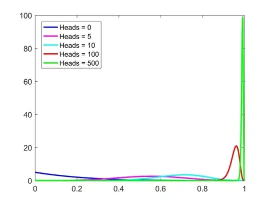

  • Nice answer. but all the super-imposed graphs are kind of confusing and it is hard to see limiting behavior. I think the graphs would illustrate the point better if they considered a roughly fixed ratio $(\alpha-1)/(\alpha+\beta-2)$ and then take $\alpha$ larger and larger, so the PDF would concentrate about that ratio. Or, a fixed $\beta$ and let $\alpha$ get larger. – Michael Jul 18 '16 at 19:02
    @Michael I created a new plot, as requested. Ended up going with a fixed $\beta$ and going with larger $\alpha$s. – Hayden Jul 18 '16 at 19:41

I think the question should have been put differently: Under the assumption that there is a fixed but unknown probability of heads $p$ can one predict or estimate its value with some degree of accuracy based on the results of the previous tosses(our data).
Now, the LLN says that under specific conditions when an experiment is repeated ad infinitum the empirical average of the outcomes comes very close and with great certainty to the theoretical average ie the mean value of the random outcome. In the case of the coin it means that if the trials are independent and the (unknown) probability of heads remains constant throughout the experiment then the frequency of appearances of heads approaches very closely and with great certainty the theoretical(and still unknown) probability of heads.
So based solely on the data one can say that the probability of heads is approximately the frequency of appearances of heads. If we see countless heads in a row and we accept the above assumptions we would be almost certain that the next one will be head.
Now if one is Bayesian, wants to play with $p$ and puts a prior uncertainty on that then one must calculate a quantity called posterior predictive probability ie Prob(head in the next trial| data) where data=the results of all previous tosses.
But as Bayesian estimates are a combination of empirical(data) and prior information when the size of your sample is very large the empirical part is dominant so I would say that the frequency of heads in a infinite number of tosses is again a safe estimate of the probability of heads.
