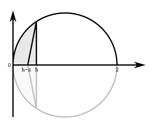

One way to construct a biased coin is to use a solid and uniformly dense spherical cap. Obviously there are only two ways it can land: on the base or on the spherical surface. To model the probabilities of each requires some integral calculus. Cross-section of the cap The cap is formed from the unit sphere centred on (1, 0, 0) and is bounded by x = h, the cap's height. The cap's radius can be found to be $\sqrt{h(2-h)}$ and the volume V is given by $$\int_0^h\pi x(2-x)dx=\pi h^2(1-\tfrac 13h)$$ The centre of mass (CM) must now be calculated. Since the cap is symmetrical about the x axis it may be reduced first to an infinitely thin rod along that axis, where the density at x = a is the cap's cross-sectional area along that plane ($\pi a(2-a)$). The reduction to a single point is another integral: $$\frac 1V\int_0^h\pi x^2(2-x)dx=h\frac{2-\frac 34h}{3-h}$$ This is the CM's distance from the origin, so it is also $h-h\frac{2-\frac 34h}{3-h}=h\frac{1-\frac 14h}{3-h}$ from the cap's base (this last value is z in the diagram).

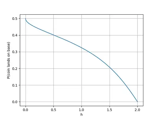

To determine the probability of this "coin" landing on its base now requires finding the solid angle subtended by the base at the CM. This analysis works because the result of letting this coin fall in a particular orientation can be taken equivalent to the face intersected by a ray from the CM in the direction of gravity. In this case the base forms a cone with the CM of height z, so the solid angle is $2\pi(1-\cos\theta)$ where $\theta$ is half the cone's apex angle. The fraction of the sphere this is, which is also the probability the coin lands on the base, is $$\frac{1-\cos\theta}2=\sin^2\frac{\tan^{-1}x}2=\frac12-\frac1{2\sqrt{x^2+1}} \text{ where }x=\frac{\sqrt{h(2-h)}}{h\frac{1-\frac 14h}{3-h}}=\frac{(3-h)\sqrt{h(2-h)}}{h(1-\frac 14h)}$$ and this simplifies to $$\frac12-\frac1{2\sqrt{1-\frac{16(h-2)(h-3)^2}{h(h-4)^2}}}$$ The plot of this expression as a function of h is shown below. It exhibits the expected behaviour at both ends: fair in the limit of a flat, infinitesimally thin coin (h = 0) and completely one-sided as a sphere (h = 2). Plot of probability of coin landing on base to h; goes from 1/2 at 0 to 0 at 2
In particular, if the desired distribution is 60/40 the ratio of cap height to sphere radius is very close to 1:2.
