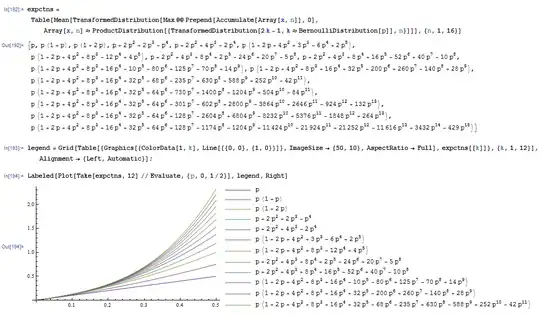

This post does not answer the OP's question, but provides certain experimental findings, which might be of interest to the OP, but which need to be established rigorously.
Representing each $X_i$ as an affine transform of the Bernoulli random variable, Mathematica can be summoned to evaluate the expectation for low values of $n$, here is the result for $0\leqslant n \leqslant 16$:enter image description here
Few observations are in order:
  • Expectations $\mathbb{E}\left(\sup\limits_{0 \leqslant k \leqslant n}S_k\right)$ appear to follow a pattern $\frac{p}{1-2p} + \mathcal{o}\left(p^{\lfloor n/2 \rfloor}\right)$, which is in agreement with the result of @did that $\mathbb{E}(S^\ast) = \frac{p}{1-2p}$.
  • Expectations appear (as suggested by Mathematica's FindSequenceFunction) to be solutions of rank $3$ linear inhomogeneous recurrence equation:
    enter image description here That is $(n+3) S_{n+3}^\ast - (n-4) S_{n+2}^\ast - 4 n p (1-p) S_{n+1}^\ast + 4(n+1) p(1-p) S^\ast_n = -p(1-2p)$
  • The generating function for the sequence of expectations $S_n^\ast$, i.e. $$g(x) = \sum\limits_{n=0}^\infty x^{n} S_n^\ast = \frac{\sqrt{4 p^2 x^2-4 p x^2+1}+2 p x-1}{2 (1-x)^2}$$

    Sum $\neq$ sup. – Did Aug 06 '12 at 17:49
  • @did Thanks, that is a typo. I meant to say $\sup$. – Sasha Aug 06 '12 at 17:52
    Then $S^\geqslant0$ almost surely since $S^$ is a supremum over $k\geqslant0$ (and not over $k\geqslant1$ as, seemingly, in your computations). – Did Aug 06 '12 at 17:59
  • @did Yes, indeed! I was using $1 \leqslant k \leqslant n$. The results are neat, I found. I will try to repeat them with $0 \leqslant k \leqslant n$ to see if similar recurrence relation holds for the expectations. – Sasha Aug 06 '12 at 18:01
  • @did I have redone the computations with $0 \leqslant k \leqslant n$. – Sasha Aug 06 '12 at 18:30
