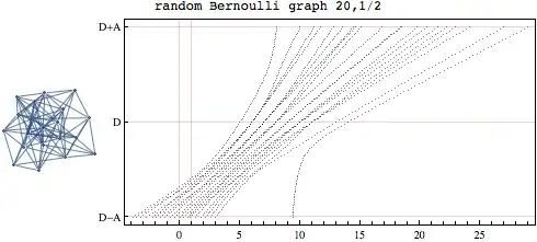

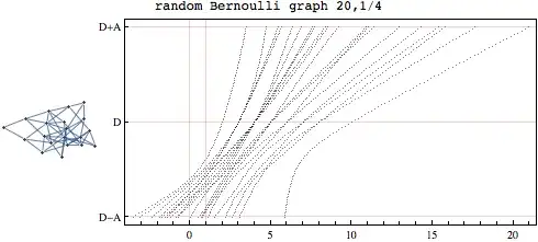

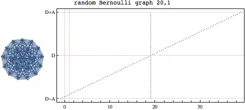

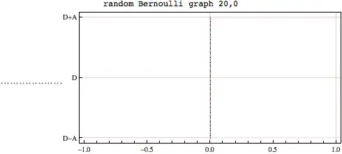

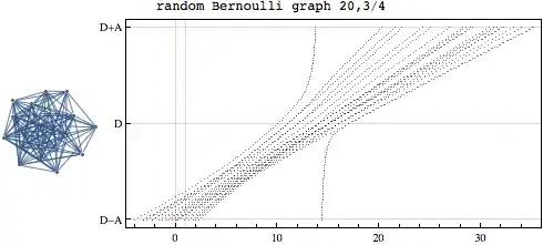

Considering the spectral function $D+\rho A$ over the interval $\rho \in [-1,1]$ rather than just the extreme values $\rho={-1,1}$, results in the curves $\lambda_i(\rho)$.
For example, the following fractional spectra are are shown as point interpolations (as opposed to curve following, as in bifurcation theory) corresponding to some random Bernoulli graphs with increasing connectivity:
These experimental results raise basic questions:
  • If graphs are $M$-cospectral on $\rho = {-1,1}$ are they cospectral for $\rho \in [-1,1]$?
  • Are there no intersections of $\lambda_i(\rho)$ outside $\rho \in [-1,1]$?
  • Does $\lim_{\lambda_i \to \infty}\frac{d\lambda_i}{d\rho} = const?$
  • What's the combinatorial interpretation of intersections in $\rho \in [-1,1]$?
Feel free to add your own conjectures.
