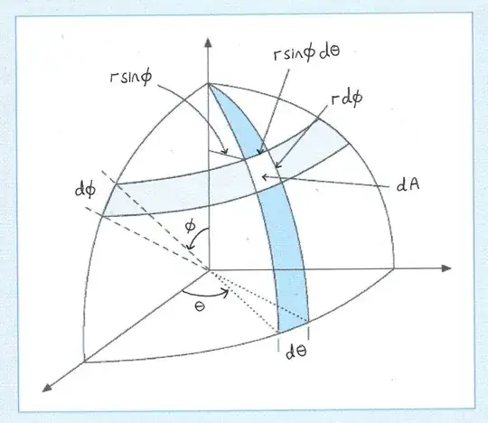

Here is a diagram that might help you to visually understand that the element of area $\text{d}A = r^2 \sin \phi \, \text{d} \phi \, \text{d} \theta.$
Note that in the diagram $0 \le \phi \le \pi $ and $ 0 \le \theta \le 2 \pi.$
alt text

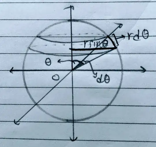

I've redrawn the picture my way, as best and clear as possible.
A ring element of the sphere
I'll answer your question one by one.
A sphere is the locus of a point described in 3 dimensionsal space such that it's distance from a fixed point in space remains constant.
Now, as you can see in the figure, with a little trigonometry, you can convince yourself that it's radius will be $r sin \theta$ ($\theta$ is measured from the Z axis towards the X-Y plane) and not simply $r$ . Now for a small change in $\theta$, the length of the arc made the radius is $r d \theta$, and here's the thing, the small ring element can be approximated as a cylinder of height $r d \theta$ and effective radius $r sin \theta$. So the area of the ring element will be
$ \displaystyle{ dA = 2 \pi (r sin \theta) (r d\theta) }$
Since Curved Surface area of a cylinder is $2 \pi (r) (h)$
Integrating will be done over the limits from 0 to $\pi$ and not 0 to $2 \pi$ for $\theta$, since the ring element is already covering the area around the Z axis on both of it's sides (will be clear from the picture), so the total area of the sphere is
$ \displaystyle{ A = 2 \pi {r}^{2} \int _{0} ^{\pi} {sin \theta d\theta} }$
Which equals,
$ \displaystyle{ A = 2 \pi {r}^{2} [- cos \pi - (-cos 0)]}$
$ \displaystyle{ \implies A = 2 \pi {r}^{2} [- (-1) +1]}$
$ \displaystyle{ \implies A = 4 \pi {r}^{2} }$
So now answer to the other questions, that you asked.
Why ${r}^{2}$ and not $r d$?
→because the $d$ here comes out to be $r sin \theta$ and thus resulting in further simplification of the expression.
Why the odd function $sin \theta$ and not $cos \theta$ ?
→Good question, it comes because it's integration with respect to $d \theta$ gives the function $- cos \theta$ which is even, thus respecting the symmetry which was expected.
If you are wondering where are these terms,
$ \displaystyle{ \int _{0} ^{2 \pi} {d\phi} }$
Here's the reason,
$ \displaystyle{ 2 \pi = \int _{0} ^{2 \pi} {d\phi} }$
This $2 \pi$ comes from the circumference term, which is due the angle $\phi$ which the angle measured from the X axis towards the Y axis.
This also answers your question of order of integration, it doesn't really matter. In my case I first integrated $d \phi$ and then $d \theta$ terms, it can also be the other way around, so you can choose an elemental semicircle ($\theta$) on the sphere and then revolve it around the sphere ($\phi$) thus summing up the area or you can do it the way I did it.
I did not use fancy words like manifold, Riemann surfaces, Jacobian etc, and I think they were also not necessary here
