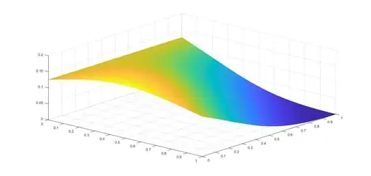

26

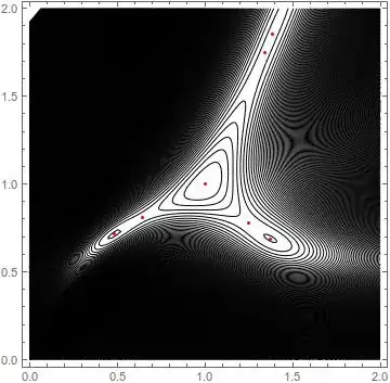

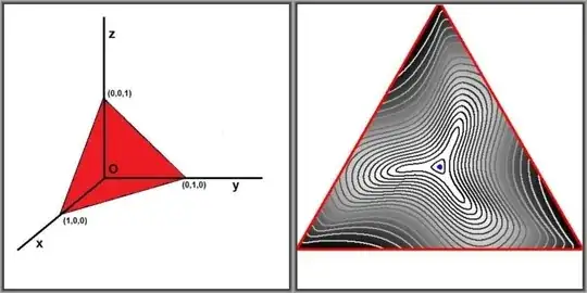

This is a question of the symmetric type, such as listed in:
With a constraint $\;x+y+z=1\;$ and $\;x,y,z > 0$ . Sort of a general method to transform such a constraint into the inside of a triangle in 2-D has been explained at length in:
Our function $f$ in this case is: $$ f(x,y,z) = \frac{x^4}{8x^3+5y^3}+\frac{y^4}{8y^3+5z^3}+\frac{z^4}{8z^3+5x^3} - \frac{1}{13} $$ And the minimum of that function inside the abovementioned triangle must shown to be greater or equal to zero. Due to symmetry - why oh why can it not be proved with Group Theory - an absolute minimum of the function is expected at $(x,y,z) = (1/3,1/3,1/3)$. Another proof without words is attempted by plotting a contour map of the function, as depicted. Levels (nivo) of these isolines are defined (in Delphi Pascal) as:
nivo := min + sqr(g/grens)*(max-min); { sqr = square ; grens = 20 ; g = 0..grens }
The whiteness of the isolines is proportional to the (positive) function values; they are almost black near the minimum and almost white near the maximum values. Maximum and minimum values of the function are observed to be:
 0.00000000000000E+0000 < f < 4.80709198767699E-0002
The little $\color{blue}{\mbox{blue}}$ spot in the middle is where $\,0 \le f(x,y,z) < 0.00002$ .

For checking purposes.
Making $y = \lambda, \ z = \mu x$ and substituting into
$$ f(x,y,z) = \frac{x^4}{8x^3+5y^3}+\frac{y^4}{8y^3+5z^3}+\frac{z^4}{8z^3+5x^3} - \frac{x+y+z}{13} $$
giving
$$ g(x,\lambda,\mu) =x\left( \frac{1}{5 \lambda ^3+8}+\frac{\lambda ^4}{8 \lambda ^3+5 \mu ^3}+\frac{\mu ^4}{8 \mu ^3+5}-\frac{1}{13} (\lambda +\mu +1)\right) $$
and discarding $x > 0$ we get
$$ \mathcal{G}(\lambda,\mu) = \frac{1}{5 \lambda ^3+8}+\frac{\lambda ^4}{8 \lambda ^3+5 \mu ^3}+\frac{\mu ^4}{8 \mu ^3+5}-\frac{1}{13} (\lambda +\mu +1) $$
Now solving the stationary conditions
$$ \nabla\mathcal{G}(\lambda,\mu) = 0 $$
we have the feasible stationary points with qualification.
$$ \left[ \begin{array}{cccl} \lambda & \mu & \mathcal{G}(\lambda,\mu) & \mbox{kind} \\ 1. & 1. & 0. & \mbox{min} \\ 0.485435 & 0.715221 & 0.000622453 & \mbox{min}\\ 0.646265 & 0.811309 & 0.000758688 & \mbox{saddle} \\ 1.37554 & 0.688678 & 0.000863479 & \mbox{min} \\ 1.25 & 0.77611 & 0.000941355 & \mbox{saddle} \\ 1.38778 & 1.85522 & 0.00123052 & \mbox{min} \\ 1.34211 & 1.74761 & 0.00123288 & \mbox{saddle} \\ \end{array} \right] $$
so the best solution is at $x = y = z = 1$
Attached the level contours for $\mathcal{G}(\lambda,\mu)$ with the stationary points in red.
Cesareo
  • 36,341
    It's not a solution, of course. How you solved this system? How you got a minimal point? If you used computer, so it's just nothing because WA says that the starting inequality is true, but it also is not a proof. @quid♦ Explain us please, why did you accept this answer? – Michael Rozenberg Jan 05 '20 at 03:21

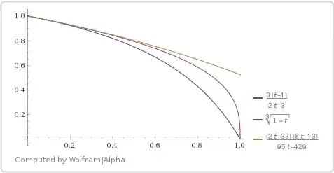

$\color{brown}{\textbf{Inequalities for cubic root.}}$
Searching of the polynomials in the forms of \begin{cases} P_4(s)=s(1+as^3) - (1+a)s^3 = as^4 -(a+1)s^3+s\\[4pt] P_7(s)=(5+8s^3)(1-b+bs^3) - s(13-c+cs^3)\\ \qquad = 8bs^6-cs^4+(8-3b)s^3+(c-13)s+5-5b \end{cases} under the conditions $$P'_4(1)=P'_7(1)=P''_7(1) = 0,$$ allows to obtain the coefficients $a,b,c:$ $$ \begin{cases} 4a-3(1+a)+1=0\\ 48b-4c+3(8-3b)+c-13=0\\ 240b-12c+6(8-3b)=0 \end{cases} \Rightarrow \begin{cases} a = 2\\ 39b-3c = -11\\ 222b-12c = -48, \end{cases} $$ $$a=2,\quad b=-\dfrac2{33},\quad c=\dfrac{95}{33},$$
then \begin{cases} P_4(s) = s(1+2s^3) - 3s^3 = s(1-s)^2(2s+1)\\ 33P_7(b)=(35-2s^3)(5+8s^3) - s(334+95s^3) = (1-s)^3(16s^3+48s^2+191s+175). \end{cases} If $s\in[0,1]\ $ then $P_4(s)\ge0,\ P_7(s)\ge0.$
Applying of the substitution $s=\sqrt[\large 3]{1-t\large\mathstrut}\ $ leads to the inequalities
$$\dfrac{(13-8t)(33+2t)}{429-95t} \ge \sqrt[\large3]{1-t\mathstrut} \ge \dfrac{3(1-t)}{3-2t}\quad\text{if} \quad t\in[0,1]\tag1$$
(see also Wolfram Alpha plot).

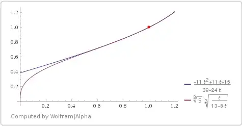

On the other hand, the function $$S(t)=\sqrt[\Large3]{\dfrac{5t\mathstrut}{13-8t}},\quad t\in[0,1]$$
has the inverse one in the form of $$T(s)=\dfrac{13s^3}{8s^3+5},\quad s\in[0,1].$$
If $s=S(t),$ then \begin{align} &\dfrac{15+11t-11t^2}{3(13-8t)}-S(t) = \dfrac{15+11T(s)-11T^2(s)}{3(13-8T(s))}-s\\[8pt] & = \dfrac{49s^6-312s^4+383s^3-195s+75}{312s^2+195} = \dfrac{(s+1)^2(7s+5)(7s^3+9s^2-30s+15)}{39(8s^2+5)},\\[8pt] &7s^3+9s^2-30s+15 = 7(1-s)(1-s^2)+8(1-s)(2-s)+s, \end{align}
$$S(t) = \sqrt[\Large3]{\dfrac{5t\mathstrut}{13-8t}} \le \dfrac{15+11t-11t^2}{3(13-8t)},\quad t\in[0,1].\tag2$$
Cubic root approximation, plot2

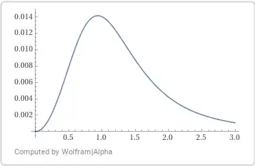

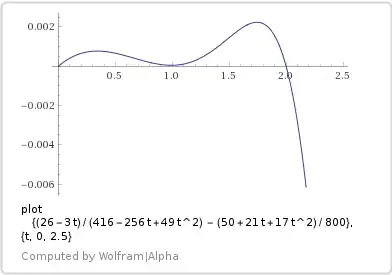

Since $$\dfrac1{49}\left(100\dfrac{13-8t}{416-256t+49t^2}+3\right) = \dfrac{(2-t)(26-3t)}{416-256t+49t^2}$$
and $$\dfrac{26-3t}{416-256t+49t^2} - \dfrac1{800}(50+21t+17t^2) = \dfrac{t(2-t)(833t^2-1657t+832)}{800(49t^2-256t+416)}$$ (see also Wolfram Alpha plot),
Ratio plot
then $$\dfrac{x^3-y^3}{8x^3+5y^3}\ge R(u+v),$$ where
$$R(t) = \dfrac1{800}(2-t)(50+21t+17t^2),\quad t\in[0,2].\tag8$$

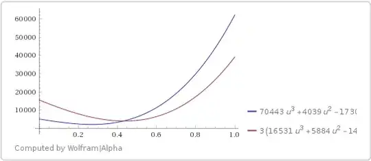

Since
Input $\!\mathstrut^{\phantom{\dfrac\mathstrut\mathstrut}^{\LARGE=}}$ Result $\!\mathstrut^{\phantom{\dfrac\mathstrut\mathstrut}^{\LARGE,}}$
then, similarly to the first case, $$g^\,_{32}(u,v)= \begin{pmatrix} 1 \\ v \\ v^2 \\ v^3 \end{pmatrix}^T \begin{pmatrix} 0 & 0 & 5055 & 10425 \\ 0 & 3390 & -3915 & 0 \\ 5055 & -24085 & -3296 & 39168 \\ 10425 & -22880 & 19808 & 0 \end{pmatrix} \begin{pmatrix} 1 \\ u \\ u^2 \\ u^3 \end{pmatrix}\\ =\begin{pmatrix} (1-v)(1-v^2) \\ v(1-v)^2 \\ v^2(1-v) \\ v^3 \end{pmatrix}^T \begin{pmatrix} 0 & 0 & 5055 & 10425 \\ 0 & 3390 & 1140 & 10425 \\ 5055 & -17305 & 40039 & 70443 \\ 15480 & -43575 & 17652 & 49593 \end{pmatrix} \begin{pmatrix} 1 \\ u \\ u^2 \\ u^3 \end{pmatrix}, $$ wherein
$$5055 - 17305u + 4039u^2 + 70443u^3 = 5055(1-2u)^2 + u(2915-16181u+70443) \ge 0,$$ $$15480 - 43575u + 17652u^2 + 49593u^3 = 15480(1-2u)^2 +3u(6115 -14756u + 16531u^2) \\ \ge0,$$ because the quadratic polynomials have negative discriminants (see also Wolfram Alpha plot).
Cubic polynomials plot
Thus, $g^\,_{32}(u,v)\ge 0$ and $g_3(u,v) \ge 0.$

Let's reform this inequality in a way such that we can comprehend it better. Define $a=\dfrac{y}{x}$ and $b=\dfrac{z}{y}$, therefore $\dfrac{x}{z}={1\over ab}$. We can suume without lose of generality that $a,b\le1$ We need to prove that $$\dfrac{x}{8+5\left(\dfrac{y}{x}\right)^3}+\dfrac{y}{8+5\left(\dfrac{z}{y}\right)^3}+\dfrac{z}{8+5\left(\dfrac{x}{z}\right)^3}\ge\dfrac{x+y+z}{13}$$by dividing the two sides of the inequality by $x$ and substituting $a,b,c$ we have that$$\dfrac{1}{8+5\left(\dfrac{y}{x}\right)^3}+\dfrac{\dfrac{y}{x}}{8+5\left(\dfrac{z}{y}\right)^3}+\dfrac{\dfrac{z}{y}}{8+5\left(\dfrac{x}{z}\right)^3}\ge\dfrac{1+\dfrac{y}{x}+\dfrac{z}{x}}{13}$$and $$\dfrac{1}{8+5a^3}+\dfrac{a}{8+5b^3}+\dfrac{a^4b^4}{5+8a^3b^3}\ge \dfrac{1}{13}+\dfrac{a}{13}+\dfrac{ab}{13}$$which is equivalent to $$\left(\dfrac{1}{8+5a^3}-\dfrac{1}{13}\right)+\left(\dfrac{a}{8+5b^3}-\dfrac{a}{13}\right)+\left(\dfrac{a^4b^4}{5+8a^3b^3}-\dfrac{ab}{13}\right)\ge 0$$by simplifying each of the components and multiplying both sides in $\dfrac{13}{5}$ we obtain$$\dfrac{1-a^3}{8+5a^3}+\dfrac{a(1-b^3)}{8+5b^3}+\dfrac{a^4b^4-ab}{5+8a^3b^3}\ge0$$below is a depiction of $f(a,b)=\dfrac{1-a^3}{8+5a^3}+\dfrac{a(1-b^3)}{8+5b^3}+\dfrac{a^4b^4-ab}{5+8a^3b^3}$ for $0\le a,b\le 1$
which proves the inequality graphically (I believe that Lagrange multipliers or any other method based on 1st order derivations may help but i hadn't much time to think on it hope you find an analytic way) but neither such a time i spent on the problem nor a computer is given us in the exam :) also i appreciate if any one updates his/her comment with such an analytical method. I'm really curious about that.....

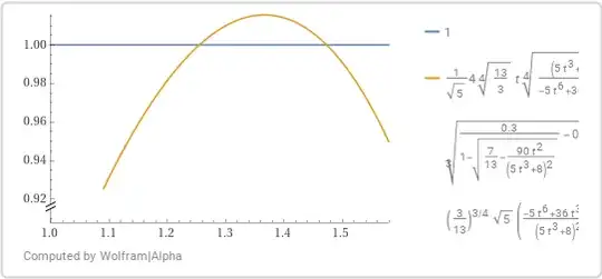

$\color{green}{\textbf{Version of 01.04.24. Common way.}}$
$\color{brown}{\;\textbf{1. Cubic in the specific form.}}$
The equation $$\dfrac{3t}{4t^3+d}=c^2,\qquad c>0,\quad c^3d\in[0,1]\tag{1.1}$$ can be solved via the trigonometric form: $$\dfrac{3ct}{4(ct)^3+c^3d}=1,\quad 3ct-4(ct)^3=c^3d,\quad \sin(3\arcsin(ct))=c^3d,$$ $$\mathbf{t_k=\dfrac1c\,sin\;\dfrac{2\pi k+\arcsin(c^3d)}3},\qquad k=0,1,2.\tag{1.2}$$ Since $\;c^3d\in[0,1],\;$ then $\;\arcsin(c^3d)\in\left[0,\dfrac\pi2\right],\;$
$$t_0=\dfrac1c\,\sin\;\dfrac{\arcsin(c^3d)}3\in\left[0,\dfrac1{2c}\right];\tag{1.3}$$ $$t_1=\dfrac1c\,\sin\;\dfrac{2\pi+\arcsin(c^3d)}3 =\dfrac1c\,\sin\;\dfrac{\pi-\arcsin(c^3d)}3\in\left[\dfrac1{2c},\dfrac{\sqrt3}{2c}\right];\tag{1.4}$$ $$t_2=\dfrac1c\,\sin\;\dfrac{4\pi+\arcsin(c^3d)}3=-\dfrac1c\,\sin\;\dfrac{\pi+\arcsin(c^3d)}3\in\left[-\dfrac{\sqrt3}{2c},-\dfrac{1}{c}\right].\tag{1.5}$$
$\color{brown}{\textbf{2. The main areas.}}$

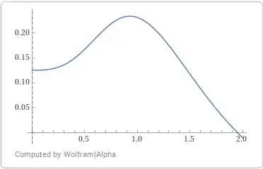

  • $\max Q(t)=Q_m=\dfrac{13\sqrt[\large3]{10}}{120}\approx0.233397091\;$at$\;t_m=\sqrt[\large3]{\dfrac45}\approx0.928317767.$
  • $Q(t)\;$ increases at $\;t\in[0,t_m];$
  • $Q(t)\;$ decreases at $\;t\in[t_m,\infty].$

  • $R(0)=\dfrac18=0.125;$
  • the positive root of $R(t)$ is $\;t_h=\sqrt[\large3]{\dfrac25\,\left(9+\sqrt{91}\right)} \approx1.950077297;$
  • $\max R(t)=R_m=\dfrac7{30}\approx0.233333333\;$ at $\;t_m=\sqrt[\large3]{\dfrac45}\approx0.928317767;$
  • $R(t)\;$ increases at $\;t\in[0,t_m];$
  • $R(t)\;$ decreases at $\;t\in[t_m,t_h];$
  • $R(t)\;$ is negative at $\;t\in(t_h,\infty).$

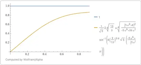

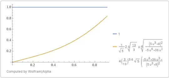

Taking in account $(1.3),(7.1),(7.2),$ easily to get $$w=h(0,u)=\dfrac1{c(u)}\,\sin\left(\dfrac13\,\arcsin\left(\dfrac{32}5\,c^3(u)\right)\right),\tag{7.3}$$ where $$с(u)=\sqrt[\large4]{\dfrac{75R(u)}{208}}\in\left[\sqrt[\large4]{\dfrac{75}{208}\,\dfrac18},\sqrt[\large4]{\dfrac{75}{208}\dfrac7{30}}\right]\subset[0.460762350,0.538571886],\tag{7.4}$$ $$\dfrac1{c(u)}\le\sqrt[\large4]{\dfrac{208\cdot8}{75}}<2.170316217,$$ $$\dfrac{32c^3(u)}5\le\dfrac{32}5\left(\dfrac{75}{208}\cdot\dfrac7{30}\right)^{\large\frac34}<0.999795113,$$ $$uh(0,u)<t_0\cdot\dfrac1{c(u)}\cdot\dfrac12<1.$$ and this contradicts with $(7.2).$
The plot of $\;uh(0,u)\;$ is shown below.
Plot of uh(0,u)

Taking in account $(1.4),$ one can get $$\begin{align} &w=h(1,u)=\sqrt[\large4]{\dfrac{208}{75}\dfrac{(8+5u^3)^2}{8+36u^3-5u^6}}\\[4pt]&\times\sin\left(\dfrac13\left(\pi-\arcsin\left(\dfrac45\left(\dfrac{75}{13}\dfrac{8+36u^3-5u^6}{(8+5u^3)^2}\right)^{\large\frac34} \right)\right)\right), \end{align}\tag{7.5}$$ wherein both of multipliers are decreasing functions of $u.$
Let $\;H(t)=\dfrac1{h(1,t)}.$
Taking in account $(7.2)$ in the form of $\;u\ge\dfrac1w,\;$ one can get:
  • for $\;u\in[0, H(0)]\qquad\quad\;\;\, u h(1,u) \le 1,\qquad H(0)\approx 0.629192687,$
  • for $\;u\in[H(0), H(H(0))]\quad u h(1,u) \le 1,\qquad H(H(0))\approx 0.805791121,$
  • for $\;u\in[H(H(0)),t_0]\qquad\; u h(1,u) \le 1,\qquad t_0\approx 0.917509714.$
Therefore,
  • for $\;u\in[0,t_0]\quad u h(1,u) \le 1.$
The plot of $\;uh(1,u)\;$ is shown below.
Plot of uW(1,u)

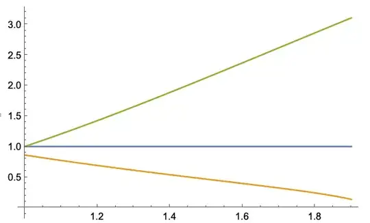

Graphic analysis of the functions $\;h(0,u)\;$ (orange line) and $\;u g(-1,u)\;$ (green line)
ug(-1,u), h(0,u)
show, that both of them allow accurate linear approximations at the interval $\;u\in(1, t_h):$ $$h(0,u)\approx 0.860147-0.796(u-1)\pm 0.0133,\quad ug(-1,u)\approx 1+2.3(u-1)\pm 0.04.$$ So their production can be approximated via quadratic function.
Therefore, the function $B(u)= u g(-1,u) h(0,u)$ is unimodal one in the interval $u\in(1,t_h).$

Let us calculate the table $$\hspace{-32mu}\begin{vmatrix} u & v=g(-1,u) & w=\theta(0,R(u)) & uvw & R(w) & Q(v)\\ \!1.25&\!1.228103035&\!0.650433454&\!0.998499124&\!0.199388943&\!0.197417010\\ \!1.26&\!1.236402046&\!0.642696247&\!1.001235004&\!0.197754855&\!0.195782736\\ \!1.47&\!1.395850784&\!0.487833698&\!1.000986283&\!0.164510886&\!0.162892269\\ \!1.48&\!1.402726182&\!0.480700601&\!0.997951152&\!0.163086876&\!0.161467543\tag{8.3} \end{vmatrix}$$
Easily to see that there are two solutions of $(7.4)$,which are situated at the intervals $(1.25,1.26)$ and $(1.47,1.48)$ accordingly. At the same time, the functions $R(w)$ and $Q(v)$ are monotonic in these intervals. In particular, in the interval $(1.25,1.26)\quad R(w)>0.1977\;$ and $\;Q(v)<0.1975.$ This means that the inequality $(7.2)$ is satisfied at the interval $\;u\in(1.25,1.26),$ including the stationary point.
Similarly, at the interval $(1.47,1.48)$ easily to get $\;R(w)>0.1630>0.1629>Q(w).$ This means that the inequality $(7.2)$ is satisfied at the interval $\;u\in(1.47,1.48),$ including the stationary point.
Plot of the equality $uvw=1$ see below.
Plotuvw=1
