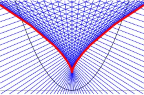

The problem here is that the normal lines (the lines perpendicular to the tangent lines) to a parabola are not parallel, as they are for straight lines.
That means that a given point in the plane can be on more than one normal line simultaneously. The question is then: which normal line do you use to reflect?
The evolute, i.e. the envelope of normal lines, is the key here. In the case of $y=x^2$, the evolute is parametrised by $x=4t^3$ and $y=3t^2+\frac{1}{2}$. This curve gives a cusp. The points "inside" the cusp lie on three different normal lines. The points outside the cusp lie on a single normal line. The points on the cusp lie on two normal lines.
The following picture is from MathWorld and show normal lines to a parabola. Notice how points inside the cusp lie on three normals, points on the cusp lie on two normals, and points outside the cusp lie on one normal.

    That's a curious way to generate a hex grid. Maybe any region for a curve having three such lines passing through could generate some hex grid. – mathreadler Apr 28 '16 at 20:28
    I suppose we could use "closest point on the parabola" to find a unique image for every point (except for some points on the axis of the parabola), but this figure shows that the mapping is not one-to-one, and with a little thought it seems clear that it also is not onto--there is a large region below the parabola consisting of points that will not be the reflected image of any point. – David K Apr 28 '16 at 20:36
    I don't see clearly how there could be such a large region below though. My intuition tells me that by continouity all points should have at least one line passing through for this particular curve. – mathreadler Apr 28 '16 at 21:10
    @mathreadler You are correct. Deciding if a normal line passes through a point in the plane reduces to solving a single variable cubic equation. These always have at least one real root, i.e. every point has at least one normal passing through it. The evolute corresponds to the cubics with a repeated root (usually one simple and one double). The inside of the evolute corresponds to three simple roots. The cusp point itself corresponds to a triple root. – Fly by Night Apr 28 '16 at 21:17
  • @mathreadler: David is saying there is a region that is not the reflected image of any point (if reflection is defined using the closest point on the parabola). I agree with him. – user21820 Apr 29 '16 at 04:17
  • Ah okay, then if it is defined by closest point I agree. – mathreadler Apr 29 '16 at 08:28

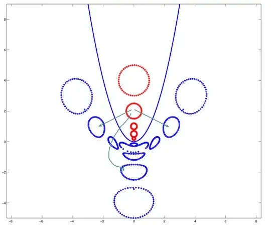

I will add the brutal (force) numerical solution ( in MATLAB).

An image from multiple runs with different circles location and shape is below. circle mirrored by parabola

  • what is the matlab picture of the reflection for the line y=x? – user Apr 29 '16 at 06:29
  • @user I can't post image in comment, you can change the code. Just change as and bs to be x and y of the line. – Taozi Apr 29 '16 at 07:08
