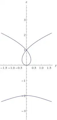

Can someone explain what reflection across a curve means geometrically? In particular, what is the reflection of the real line $y=0$ across the parabola $y=x^2$?

Now you have every piece needed to get the points I mentionned above. Suppose you have your old plane with an orthonormal frame and look at the parabola $y=x^2$.
If you consider the variety $\{(x,y) \in \Bbb C^2 \mid y = x^2\}$, and try to plot its complex points, you get a set of pairs $(A,B)$ where $B$ is antiholomorphic in $x$ (or $y$, because $x \mapsto y$ is holomorphic) and $A$ is holomorphic in $x$. Which means that locally, $B$ varies anti-holomorphically in $A$.
This means that locally, the assignment $A \mapsto B$ is an antiholomorphic function that fixes the real points of the parabola, so it must be the schwarz reflection around it.
Given a point $A$, the question of finding the points $B$ such that $(A,B)$ is a complex point of the parabola is the same as asking what are the intersection points of the line going through $\textbf A$ and slope $i$, and in the case of a conic, there usually are two of them.
The branch points occur when you get a double point i.e. when the variety is tangent to that line of slope $i$. Normally if you have a nondegenerate conic you will find two branch points (which happen to be the two foci of the conic because what else could they be, really ?), but in the case of the parabola one of them is "at infinity" : if you have $A$ follow a large circle, then the corresponding $B$ will also follow a large circle-ish shape in the other orientation, but it won't come back to its starting point, you will have to make two loops for that.
This complex affine plane model is a natural (but also kinda strange) way to look at complexified real curves together with their distinguished real component. You can do some funny things like finding the intersection points of two circles that don't intersect in real points, or of a circle and a line (by the way, the complex points of a real circle are the pairs $(A,B)$ where $B$ is the image of $A$ by the inversion through the circle).
As for your concrete example, to find $(y,z)$ such that the point $((x,0),(y,z))$ is on the parabola, you can either solve for $t$ such that $(x+t,it)$ satisfies $Y=X^2$ and translate $(x,0)$ by $2(\Re t, -\Im t)$ (or $2\bar t$ with the slight abuse of notation),
or you can find the complex coordinates of $((x,0),(y,z))$ and write $Y=X^2$. This gives you two equations, use one to eliminate $x$, and you will obtain a degree $4$ equation on $y$ and $z$, which if I'm not mistaken, is
$y^2(1+z)^2+2y^2(1-z^2)+(y^2-z^2)(1-z)^2 = 2z(1-z)^2$
The node corresponds to the two complex points $((\pm \sqrt 3,0),(0,1))$ so they are the images of $(\pm \sqrt 3,0)$ by the reflection.
