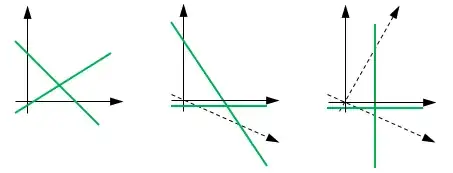

Linear algebra is all about basis-change. Matrices are change of basis machines !
When you form a linear combination $a\vec u+b\vec v+\cdots c\vec w$, you can see it as the vector $(a,b,\cdots c)$ expressed in the basis $(\vec u,\vec v,\cdots \vec w)$.
For the same reason, a matrix product $AB$ expresses what the matrix $A$ becomes when applied to the vectors of the matrix $B$. And think that most matrix operations can be described as products of elementary transforms (which are changes of basis involving one axis or two).
Looking at the resolution of a system of linear equations, you can see it as a change of basis such that the hyperplanes corresponding to the equations become parallel to the axis, so that computing their intersections becomes trivial.

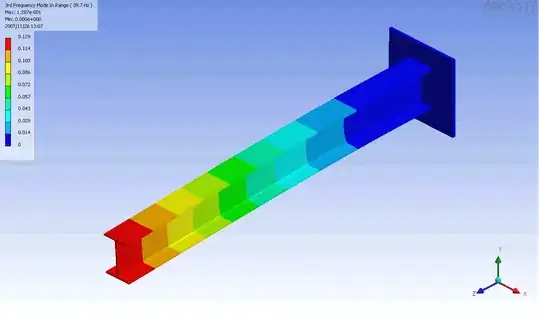

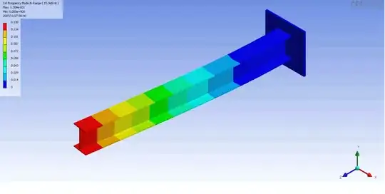

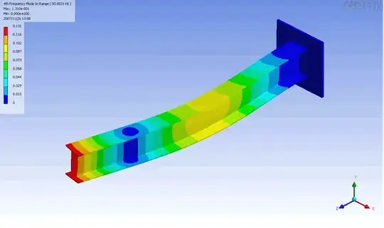

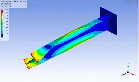

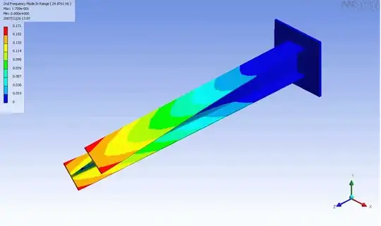

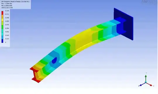

Structural dynamics with the Finite Element Method
Computing the dynamic response of a structure is done with modal analysis.
The original vector space is displacements and rotations in each node. These are unsuited to dynamic response. The system of equations is therefore transformed into a new vector space where each element in the vector space represents a vibration mode.
Wikipedia has some nice animations of vibration modes, ordered from lowest to highest frequency: Mode 1 Mode 2 Mode 3 Mode 4 Mode 5 Mode 6
Each mode (eigenvector) is the vibration to a specific frequency (eigenvalue). When these have been found, we can compute interesting stuff like the structural response to an earthquake of a certain frequency spectrum. Afterwards, the basis is changed back to the original to obtain forces and displacements in each node.
