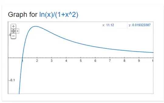

At the risk of stating the obvious, I would suggest examining the curve of ${\ln x}\over{(1+x^2)}$:
The geometrical interpretation is that the area below the $x$-axis down to the curve from 0 to 1 is equal to the area above the $x$-axis up to the curve from 1 to infinity.
