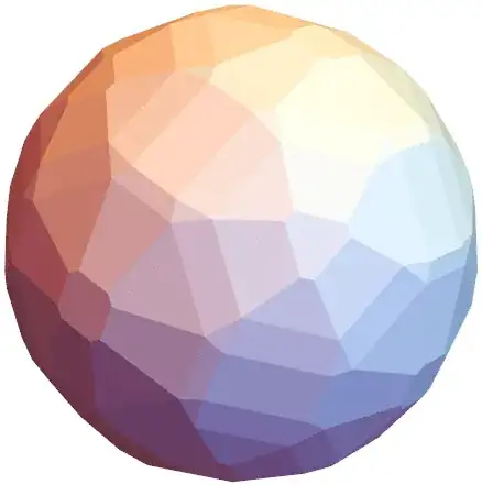

Take $R$ as the real root of ($x^3-6 x^2 + 4 x-2=0$). This value deserves a name, since $(R^{24} -24) - e^{\pi \sqrt{163}} <10^{-14}$. That $R$ can generate this figure, which seems more interesting than polyhedra I made with Narayana's cow.
moonshine polyhedron

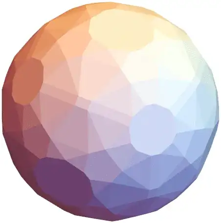

When generating from $a + b R^c$, the bounds on $a$, $b$, $c$ matter. If all values are between -3 and 3, then we might say a particular polyhedron is easily generated by $R$. The higher the bound, the greater the difficulty. With a bound of 17, $$(0, 5, 17), (1, 12, 13), (3, 4, 17), (3, 7, 16), (5, 8, 15), (7, 11, 12), (8, 9, 13)$$ all have the same norm ($\sqrt{314}$), and can generate this figure:
points at 314
