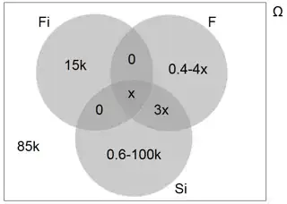

To solve this question, I have defined the following events:
$A:$ Event that the pet is forest A.
$F_i:$ Event that he finds his pet on day $i.$
$S_i:$ Event that he searches forest A on day $i.$
Venn diagram
The question asks which one of $ P(F_i | S_i) $ and $ P(F_i | S_i') $ is bigger. Now, as far as I understand, solving the question with only this much information is not possible. I guess that in order to solve the question, I need to assume that $S_i$ and $A$ are independent events. Intuitively, this is a sound assumption because by the wording of the question, it seems like Tim chooses the forest to search totally at his own wish. By common sense, I have concluded that $S_i$ and $A$ must be independent. When I solve the question using this assumption, I do the algebra and get $P(F_i | S_i) = 0.1 $ and $ P(F_i | S_i') = 0.09 $.
However, I am not exactly sure whether these two events are indeed independent. By common sense and intuition, I have concluded that these events are independent. However, I don't have mathematical arguments, or any kind of argument that is more rigorous than common sense and intuition to back up this assumption.
So my question is this: How can I rigorously determine whether two events are independent? By the way, note that an argument such as "to rigorously determine whether two events A and B are independent, simply check whether the equation $ P(A \cap B) = P(A) * P(B) $ holds" is totally invalid. Because I want to know whether events $A$ and $B$ are independent in the case that I don't know $ P(A \cap B) $ or $ P(A) $ or $ P(B) $. I want to make inferences on $ P(A \cap B) $ or $ P(A) $ or $ P(B), $ not to validate my calculations on $ P(A \cap B) $ and $ P(A) $ and $ P(B) .$

The problem presents a narrative (i.e. non-mathematical) scenario. You used that narrative to create a Venn diagram. The process by which you converted the narrative to the diagram was not "rigorous," in the usual sense of the word. It is a process that involves a combination of intuition and mathematics. Once you have the Venn diagram (which is a representation of a probability space), you can do rigorous mathematics.
Now, the problem only asks you to consider the first day. So you only need $i = 1$. You cannot mathematically determine the independence of $S_1$ and $A$ from your Venn diagram. This should be clear. Simply find valid values of $x$ and $k$ that make $S_1$ and $A$ dependent.
This means you need to go back to the narrative and continue the process you started earlier. That is, you must use a combination of intuition and mathematics to argue that the independence of $S_1$ and $A$ is something that should be added to your Venn diagram.
Here is one possible line of argumentation: The event $S_1$ is a choice that Tim makes, prior to doing any searches whatsoever. Also, $P(A) = 0.4$ is a probability that is based on Tim's knowledge before doing any searches. Mathematics tells us that if $S_1$ and $A$ were not independent, then either $P(A \mid S_1) > P(A)$ or $P(A \mid S_1) < P(A)$. If that were the case, then somehow, the very act of choosing would change the probability of $A$. Since this doesn't make any sense, we should stipulate that they are independent.
