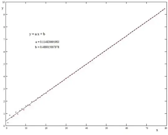

  • Not sure what you are trying to do. After initial oscillations, the fit to a line gets better and better as the point index increases. Why do you split in two subsets ? –  Feb 05 '16 at 09:50
  • @Yves: the splitting is done to have some sanity check of the procedure. For how many current data-points I'll do any optimizaton, there will be infinitely many more for which that optimization must be sensical. The problem is that an estimation will always face the problem that I have to extrapolate to hiher indexes. So this splitting shall give some indication, whether the found optimization can be meaningful at all. Consider the polynomial interpolation. I did it with first forty points and got exact fit. But extrapolated to further points showed catastrophic error, so this splitting... – Gottfried Helms Feb 05 '16 at 10:29
  • ... was an instrument to uncover the inappropriateness of the polynomial interpolation at all. I think the same applies to any method - even with this regression-model. – Gottfried Helms Feb 05 '16 at 10:30
  • Polynomial interpolation is indeed unusable above, say, ten points. But regression behaves very well, except in the case of outliers. In your case I see a nice linear law and I wonder why you want to complexify the model. The initial points are a little dangerous because of the oscillations, which aren't modelled, but they decay steadily. I would just ignore the first 20 or so. I still can't understand your intent. –  Feb 05 '16 at 10:40
  • @Yves - well actually I used that linear interpolation as rough approximation (as well as a more sophisticated formula, but that's complete different path, see the new link in my updated answer). I just saw room for improvement and tried to make sense of the above regression-model. My problem is simply to derive the solution for the parameters for a regression, where the data-to-be-fit (resp. the intended residuals) are in the denominator of the regression-formula which is quite unusual for me. I thought there might be some (simple) canonical answer for such a question. – Gottfried Helms Feb 05 '16 at 11:11

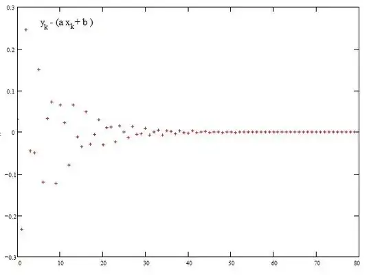

  • From what I have seen, the residuals are oscillating around a straight line and adding non-oscillating terms won't help. But I can be wrong. –  Feb 05 '16 at 11:26

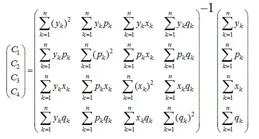

If I well understand the question, you have the data $(x_k\:,\:y_k)$ where $k=1$ to $k=n$ ( in your example $n=80$ and $x_k=k$ ).
As the problem is settled, this is not exactly the fitting of a function to the data but in fact the fitting of an equation to the data, which is slightly different. The equation is : $$\frac{1}{y-(a_0+a_1x)} - (b_0+b_1x)=0$$ The goal is to find approximates for $a_0\:,\:a_1\:,\:b_0\:,\:b_1$ so that the equation be at best satisfied. $$ \left(y-(a_0+a_1x)\right)(b_0+b_1x)-1=0$$ $$b_0y+b_1xy-(a_1b_0+a_0b_1)x-a_1b_1x^2=1+a_0b_0$$ Let : $\quad C_1=\frac{b_0}{1+a_0b_0}\quad;\quad C_2=\frac{b_1}{1+a_0b_0}\quad;\quad C_3=-\frac{a_1b_0+a_0b_1}{1+a_0b_0}\quad;\quad C_4=-\frac{a_1b_1}{1+a_0b_0}$
Then, compute for $k=1$ to $k=n$ : $\quad p_k=x_ky_k \quad \text{and}\quad q_k=x_k^2$
The regression with linear mean square fitting of : $$C_1y_k+C_2p_k+C_3x_k+C_4q_k\simeq1$$ will lead to $\:C_1\:,\:\:C_2\:,\:\:C_3\:,\:\:C_4\:$. Then, with the four relationships with $\:a_0\:,\:\:a_1\:,\:\:b_0\:,\:\:b_1\:$ one can compute the approximates of those four parameters.
I didn't test this method with your data because a simple linear regression seems convenient and leads to a very good fitting , or have I missed something ? :

  • Step 1: Yes, I've done the same regression and got the same/a similar result. Step 2: But after that I looked at the residuals and noticed, that they have a trend to become absolutely smaller. So I considered to do a further improvement to find a characteristic of that. Looked at the residuals and at their reciprocals - observing/guessing that there is another linear trend. Thus the residuals of Step 1(as of your finding) are in the denominator of my formula and I tried -as a higher order approximation- to get something useful by removing that trend. That's the reason for my complete formula. – Gottfried Helms Feb 05 '16 at 14:32
  • OK. But looking at the magnitude of scatter on the left side of the curve, on my pinion, such an expected improuvement is questionable . Anyways, you are the sole judge. – JJacquelin Feb 05 '16 at 14:45
