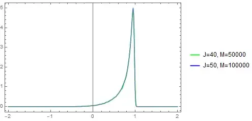

Let us do a numerical example. Choose $T=1$. Write
distribution1 = distributionIT[1, 40, 50000];
plot1 = Plot[PDF[distribution1, x], {x, -2, 2}, Frame -> True, PlotRange -> All];
distribution2 = distributionIT[1, 50, 100000];
plot2 = Plot[PDF[distribution2, x], {x, -2, 2}, Frame -> True, PlotRange -> All];
Legended[Show[plot1, plot2], LineLegend[{Green, Blue}, {"J=40, M=50000", "J=50, M=100000"}]]
We plot the estimated density function for $J=40$, $M=50000$ and $J=50$, $M=100000$. We observe no differences, so our method provides a good approximation of the probability density function of $I(1)$.

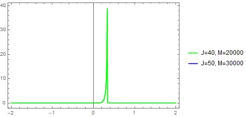

Similar computations for $T=0.34$ give the following plot:
If you plot the approximate density function for smaller $T$, you will see that at the end one gets a Dirac delta at $0$, which agrees with the fact that $I(0)=0$ almost surely.
