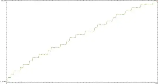

Result for $(6)$ using the Gram series and the $100$ first non trivial zeros in $(2..100)$ : <span class=$x\in (2..100)$" />
