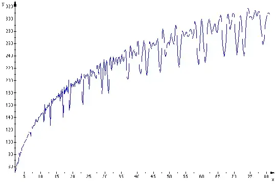

I am considering the following term from the Riemann explicit formula (see here >>>):
$$\sum_{\rho(\Im>0)}{\mathrm{li}(x^\rho)}$$
with $\rho$ non-trivial zeros of $\zeta$-function.
I have a plot of this sum up to the first $100$ non-trivial zeros, see below. The oscilations are around a curve profile.
What is the function $f(x)$ for this curve profile, along which the above sum is oscillating? How can we get to this function analytically? Is there any reference?
APPEND: Meanwhile I found some approximation but can not find to the analytic relation. So may be the question could say: Why does the following function could be an approxiamtion for this profile curve?
$$f(x)=\frac{1}{2}\sum_{\rho(\Im>0)}{\mathrm{li}(x^{1/2})}$$

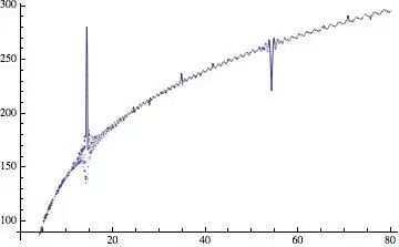

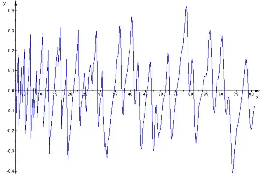

Let's compare the result using $\,\mathrm{Ei}(\ln x^{\rho_i})\,$ (your picture with $\,n=100$) : your fig.

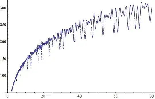

with the actual result for $(1)$ : sum 1
Riemann's explicit formula restrained to the $\,(2)n\,$ 'smallest' non trivial zeros is (for $x>1$ and using $\,\mathrm{Ei}(\overline{\rho_i}\ln x)=\overline{\mathrm{Ei}(\rho_i\ln x)}$ for the $n$ first complex zeros with negative imaginary part): $$\tag{2}\Pi_{n}(x)=\mathrm{Ei}(\ln(x))-\sum_{k=1}^\infty \mathrm{Ei}(-2k\,\ln x)-2\,\Re\,S_n(x)$$ may then be used to visualize the Riemann Prime Counting Function $\Pi$.

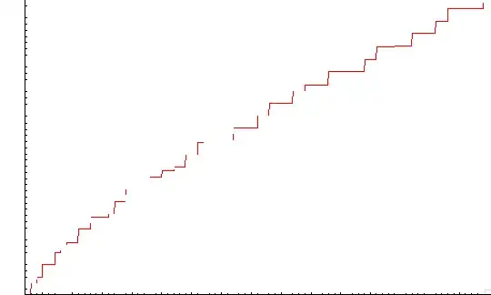

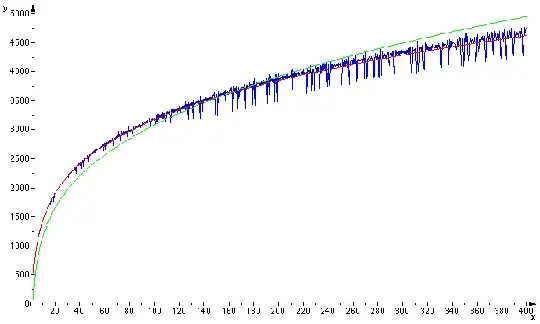

For $n=100$ we get : PI0 that we may compare to the actual $\;\displaystyle\Pi(x)=\sum_{p^k<x}\frac 1k$ : real PI0
The artifact was thus eliminated but, out of curiosity, can we approximate it?

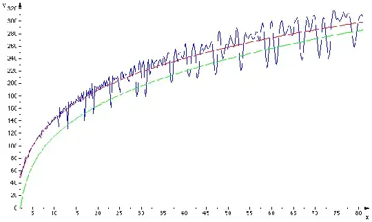

The actual error is of course given by the evaluation of (with $[x]$ the nearest integer) : \begin{align} \tag{3} \Delta_n(x)&:=\Re\sum_{i=1}^n \mathrm{Ei}(\ln x^{\rho_i})-\mathrm{Ei}(\rho_i\ln x)\\ \tag{4} &=\Re\sum_{i=1}^n \mathrm{Ei}\left(\frac{\ln x}2+\left(\frac{\Im\rho_i\ln x}{2\pi}-\left[\frac{\Im\rho_i\ln x}{2\pi}\right]\right)2\pi\,i\right)-\mathrm{Ei}(\rho_i\ln x)\\ \end{align} Which gives nearly your initial picture (observe the bounds on my second picture suggesting to neglect the right part :$\,\Re\sum_{i=1}^n\mathrm{Ei}(\rho_i\ln x)\,$). One could think at neglecting the imaginary part in the first term and write $\:\Delta_n(x)\approx\Re\sum_{i=1}^n \mathrm{Ei}\left(\frac{\ln x}2\right)=n\,\mathrm{li}(x^{1/2})$. This corresponds to your conjecture but only if divided by a value near of $2$.
A more precise result is obtained with the average value of $\;\mathrm{Ei}\left(\frac{\ln x}2+ti\right)$ for $t$ in $(-\pi,\pi)\,$ which can be done using integration by parts to get $\;\displaystyle\int \mathrm{Ei}(x) dx= x\mathrm{Ei}(x)-e^x\;$ and the better approximation : $$\tag{5}\Delta_n(x)\approx \left.-\,\frac n{2\pi}\,i\,\left(\frac{\ln x}2+ti\right)\mathrm{Ei}\left(\frac{\ln x}2+ti\right)\right|_{t=-\pi}^\pi $$
illustrated by following figure with $(5)$ in red and the OP's approximation $\;n\,\mathrm{li}(x^{1/2})/2$ at the bottom: approx 100
With $n=1000$ zeros (instead of $100$) and a larger range the approximation $(5)$ seems the only one to remain reliable : approx 1000
