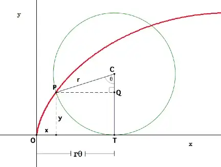

Okay so we have
Cycloid Image
So we know that, like you said, we can express the position vector of $P$, as the sum of three other vectors, that is, according to this image, $$\vec{OP}=\vec{OT}+\vec{TC}+\vec{CP}$$ And I'm not going to go through it all because you already know it, but what seems to be giving issues is that $$\vec{CP}=<-r\sin(\theta),-r\cos(\theta)>$$ and you are wondering why it is always $-r$ because it looks like the signs of the components of this vector should be changing every quadrant of the circle. Well in this case it is helpful to refer back to the unit circle.
Unit Circle
And we can see that when $\theta \le \frac{\pi}{2}$, both components of the vector should be negative; which lines of with both sine and cosine being positive and then multiplied by the negative coefficient $-r$. Then for $\frac{\pi}{2}<\theta\le \pi$ we know that the vertical component should be positive and the horizontal should be negative, which once again lines up with the fact that sine remains positive but cosine becomes negative.
And so on, you can continue to check these and they all checkout, hence the coefficient $-r$ should always be negative and you end up with a minus in the final position vector.
