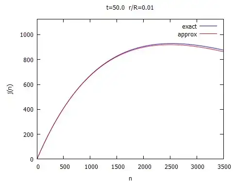

 0.1          29                   10.4             25
 0.01         2550                 929.7            2500
(There's only a few hundred trials in the r=0.01 sim, so 2550 might not be super accurate.) So I'm going to pick it for the answer. I'd like to thank everyone for their contributions, this has been a great learning experience.

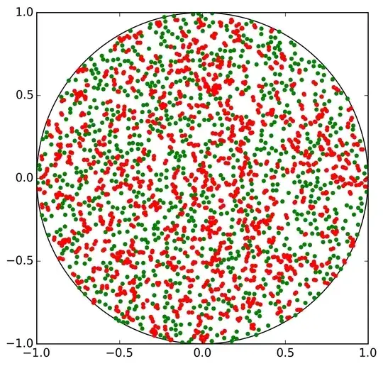

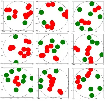

Here are a few pictures of a simulation for r/R = 0.1581, n=12: enter image description here

I wrote a little simulation. I'll paste the code below so it can be checked (edit: it's been fixed to correctly pick points randomly on a unit disc). I've looked at two three cases so far. First case, r = 0.1581, R = 1, which is roughly p = 0.1 by mzp's notation. At these parameters I got n* = 12 (free pepperoni = 4.52). Arthur's expression did not appear to be maximized here. leonbloy's answer would give 10. I also did r = 0.1, R = 1. I got n* = 29 (free pepperoni = 10.38) in this case. Arthur's expression was not maximized here and leonbloy's answer would give 25. Finally for r = 0.01 I get roughly n*=2400 as shown here:enter image description here
Here's my (ugly) code, now edited to properly pick random points on a disc:

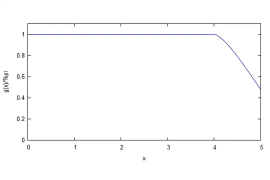

Let $$t = \frac{R}{2r}$$
(Equivalently, think of $t$ as the pizza radius, and assume a pepperoni of radius $1/2$). Assume $t>1$. Let $g(x)$ be the area of a unit circle, at a distance $x$ from the origin, intersected with the circle of radius $t$. Then
$$g(x)=\begin{cases}\pi & {\rm if}& 0\le x \le t-1\\ h(x) & {\rm if}& t-1<x \le t \\ 0 & {\rm elsewhere} \end{cases} \tag{3}$$ where $$h(x)=\cos^{-1}\left(\frac{x^2+1-t^2}{2x}\right)+t^2 \cos^{-1}\left(\frac{x^2+t^2-1}{2xt}\right) -\frac{1}{2}\sqrt{[(x+t)^2-1][1-(t-x)^2]} \tag{4}$$
Here's a graph of $g(x)/\pi$ for $t=5$ enter image description here

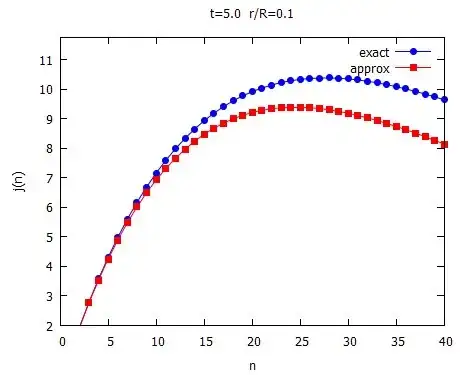

[**] Some Maxima code to evaluate (numerically) the exact solution $(7)$:
h(x,t) :=   acos((x^2+1-t^2)/(2*x))+t^2*acos((x^2-1+t^2)/(2*x*t))
  -sqrt(((x+t)^2-1)*(1-(t-x)^2))/2 $
j(n,t) := n * ( (1-1/t)^2*(1-1/t^2)^(n-1)
  + (2/t^2) *  quad_qag(x * (1-h(x,t)/(%pi*t^2))^(n-1),x,t-1,t ,3)[1]) $
j0(n,t) := n *(1-1/t^2)^(n-1)$

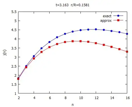

tt : 1/(2*0.1581) $
j(11,tt);
4.521719308511862
j(12,tt);
4.522913706608645
j(13,tt);
4.494540361913981
tt : 1/(2*0.1) $
j(27,tt);
10.37509984083333
j(28,tt);
10.37692859747294
j(29,tt);
10.36601271146961

plot2d([[discrete,nn,jnn],[discrete,nn,j0nn]],
    [legend,"exact","approx"],[style,[linespoints,1,2]],[xlabel,"n"],  [ylabel,"j(n)"],
[title,concat("t=",tt, "  r/R=",1/(2*tt))],[y,2,tt^2*0.5]);
The first result agrees with the OP simulation, the second is close: I got $n^{*}=28$ instead of $29$. For the third case, I get $n^{*}=2529$ ($j(n)=929.1865331$)

  • This looks pretty good for r = 0.01, R = 1 -- it predicts n* = 2500 which is what I'm getting with simulation, roughly. – Ben S. Dec 09 '15 at 21:04
