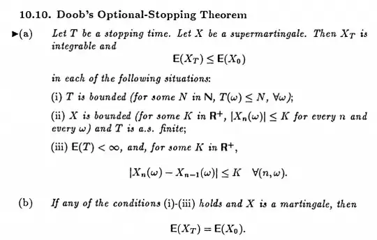

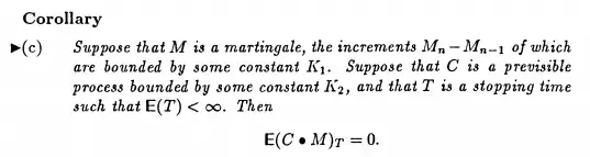

Attempted Proof 2 uses Doob's Optional-Stopping Theorem (c) $(*)$:
$$E[X_{T \wedge n}] = (p-q)E[T \wedge n]$$
$$|M_{n+1} - M_n| = |Y_{n+1} - p + q| \le 1 + p - q = K$$
Consider previsible process $C_n = 1$
Use Doob's Optional-Stopping Theorem (c) $(*)$ on $(C \cdot M)$ to get:
$$E[(C \cdot M)_T] = 0$$
$$\to E[M_T] - E[M_0] = 0$$
$$\to E[M_T] - 0 = 0$$
$$\to E[M_T] = 0$$
$$\to E[X_T - T(p-q)] = 0$$
$$\to E[X_T] - E[T(p-q)] = 0$$
$$\to E[X_T] = E[T(p-q)]$$
$$\to E[X_T] = (p-q)E[T]$$
$$\to E[b] = (p-q)E[T]$$
$$\to b = (p-q)E[T] \ QED$$
$(*)$ Doob's Optional-Stopping Theorem:
