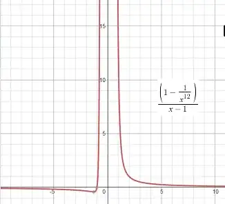

For your equation $8.3838x^{13}-9.3838x^{12}+1=0$ you have the equivalent one $$8.3838(x^{13}-x^{12})=x^{12}-1\iff 8.3838=\frac{x^{12}-1}{x^{13}-x^{12}}=\frac{1-1/x^{12}}{x-1}$$
Consider separately the function $f(x)=\frac{1-1/x^{12}}{x-1}$.
You have f(-1)=0. $f(1.06)\approx 8.384$ and $f(-0.794)\approx 8.34$ and other approximated values. You can see the special value $x=1.06$ gives a "good" approximated root.
Here the graph of $f$
