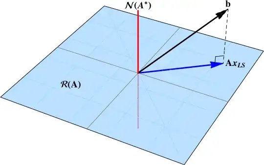

Only $\color{red}{\mathcal{N}_{\mathbf{A}}}$ is trivial: full column rank, row rank deficit
This is the overdetermined case, also known as the full column rank case: $m>n$, $\rho=n$. $$ \Sigma = \left[ \begin{array}{c} \mathbf{S} \\ \mathbf{0} \end{array} \right] $$ The pseudoinverse provides the same solution as the normal equations: $$ \begin{align} % \mathbf{A} & = % \left[ \begin{array}{cc} \color{blue}{\mathbf{U_{\mathcal{R}}^{*}}} & \color{red}{\mathbf{U_{\mathcal{N}}}} \end{array} \right] % \left[ \begin{array}{c} \mathbf{S} \\ \mathbf{0} \end{array} \right] % \color{blue}{\mathbf{V_{\mathcal{R}}}} \\ % Apinv \mathbf{A}^{\dagger} & = % \color{blue}{\mathbf{V_{\mathcal{R}}}} \, \left[ \begin{array}{cc} \mathbf{S}^{-1} & \mathbf{0} \end{array} \right] % \left[ \begin{array}{c} \color{blue}{\mathbf{U_{\mathcal{R}}^{*}}} \\ \color{red}{\mathbf{U_{\mathcal{N}}^{*}}} \end{array} \right] \end{align} $$ The inverse from the normal equations is $$ \begin{align} \left( \mathbf{A}^{*}\mathbf{A} \right)^{-1} \mathbf{A}^{*} &= % \left( % \color{blue}{\mathbf{V_{\mathcal{R}}}} \, \left[ \begin{array}{cc} \mathbf{S} & \mathbf{0} \end{array} \right] % \left[ \begin{array}{c} \color{blue}{\mathbf{U_{\mathcal{R}}^{*}}} \\ \color{red}{\mathbf{U_{\mathcal{N}}^{*}}} \end{array} \right] % A \left[ \begin{array}{cx} \color{blue}{\mathbf{U_{\mathcal{R}}}} & \color{red}{\mathbf{U_{\mathcal{N}}}} \end{array} \right] \left[ \begin{array}{c} \mathbf{S} \\ \mathbf{0} \end{array} \right] \color{blue}{\mathbf{V_{\mathcal{R}}^{*}}} \, % \right)^{-1} % A* % \left( \color{blue}{\mathbf{V_{\mathcal{R}}}} \, \left[ \begin{array}{cc} \mathbf{S} & \mathbf{0} \end{array} \right] % \left[ \begin{array}{c} \color{blue}{\mathbf{U_{\mathcal{R}}^{*}}} \\ \color{red}{\mathbf{U_{\mathcal{N}}^{*}}} \end{array} \right] \right) \\ \\ % &= % \color{blue}{\mathbf{V_{\mathcal{R}}}} \, \left[ \begin{array}{cc} \mathbf{S}^{-1} \, \mathbf{0} \end{array} \right] % \left[ \begin{array}{c} \color{blue}{\mathbf{U_{\mathcal{R}}^{*}}} \\ \color{red}{\mathbf{U_{\mathcal{N}}^{*}}} \end{array} \right] \\ % &= \mathbf{A}^{\dagger} % \end{align} $$ The figure below shows the solution as the projection of the data vector onto the range space $\color{blue}{\mathcal{R}(\mathbf{A})}$.

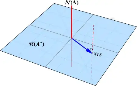

This is an underdetermined case, also known as the full row rank case: $m<n$, $\rho=m$. We lose uniqueness and the solution will be an affine space. $$ \Sigma = \left[ \begin{array}{cc} \mathbf{S} & \mathbf{0} \end{array} \right] $$ The target matrix and pseudoinverse are: $$ \begin{align} % \mathbf{A} & = % \color{blue}{\mathbf{U_{\mathcal{R}}}} \, \left[ \begin{array}{cc} \mathbf{S} & \mathbf{0} \end{array} \right] % \left[ \begin{array}{c} \color{blue}{\mathbf{V_{\mathcal{R}}^{*}}} \\ \color{red} {\mathbf{V_{\mathcal{N}}^{*}}} \end{array} \right] % \\ % Apinv \mathbf{A}^{\dagger} & = % \left[ \begin{array}{cc} \color{blue}{\mathbf{V_{\mathcal{R}}}} & \color{red} {\mathbf{V_{\mathcal{N}}}} \end{array} \right] \left[ \begin{array}{c} \mathbf{S}^{-1} \\ \mathbf{0} \end{array} \right] % \color{blue}{\mathbf{U_{\mathcal{R}}^{*}}} % \end{align} $$ The inverse matrix is $$ \begin{align} \mathbf{A}^{*} \left( \mathbf{A} \, \mathbf{A}^{*} \right)^{-1} % &= % \left[ \begin{array}{cc} \color{blue}{\mathbf{V_{\mathcal{R}}}} & \color{red} {\mathbf{V_{\mathcal{N}}}} \end{array} \right] \left[ \begin{array}{c} \mathbf{S}^{-1} \\ \mathbf{0} \end{array} \right] % \color{blue}{\mathbf{U_{\mathcal{R}}^{*}}} \\ % &= \mathbf{A}^{\dagger} % \end{align} $$
The least squares solution is the affine space $$ \begin{align} x_{LS} = \color{blue}{\mathbf{A}^{\dagger} b} + \color{red}{ \left( \mathbf{I}_{n} - \mathbf{A}^{\dagger} \mathbf{A} \right) y}, \qquad y \in \mathbb{C}^{n} \\ \end{align} $$ represented by the dashed red line below.

The matrix $A$ typically has many more rows than columns --- lets imagine $200$ rows and $3$ columns. The $200\times1$ vector $b$ is typically not in the column space of $A$, so the equation $Ax\overset{\Large\text{?}}=b$ has no solution for the $3\times1$ vector $x$. The problem is to find the value of $x$ that makes $Ax$ as close as possible to $b$, in that $\|Ax-b\|$ is as small as possible. The solution is the orthogonal projection of $b$ onto the column space of $A$. The entries in $x$ are the coefficients in a linear combination of the columns of $A$.
Vectors in the column space of $A$ are precisely vectors of the form $Ax$.
If the matrix $A$ has full rank (in our example, rank $3$), i.e. it has linearly independent columns, then the $3\times3$ matrix $A'A$ is invertible; otherwise it is not.
Consider the $200\times200$ matrix $Hu = A(A'A)^{-1}A'$, which has rank $3$. If a $200\times1$ vector $u$ is in the column space of $A$, then $Hu=u$. This is proved as follows: $$ Hu = A(A'A)^{-1} A'\Big( Ax\Big) = A(A'A)^{-1}\Big(A'A\Big) x = Ax = u. $$ If $u$ is orthogonal to the column space of $A$, then $Au=0$, as follows: $$ Hu = A(A'A)^{-1} (A'u),\qquad\text{and }A'u=0. $$ Thus $u\mapsto Hu$ is the orthogonal projection onto the column space of $A$.
So the least-squares solution satisfies $Hb = Ax$.
Thus $A(A'A)^{-1}A'b = Ax$.
If $A$ has a left-inverse, by which we can multiply both sides of this equation on the left, then we can get $(A'A)^{-1} A'b = x$, and that's the least-squares solution.
That left-inverse is $(A'A)^{-1}A'$, as can readily be checked.
If the columns of $A$ are not linearly independent, then each point in the column space can be written as $Ax_1 = Ax_2$ for some $x_1\ne x_2$. In that case, the least-squares solution is not unique.
