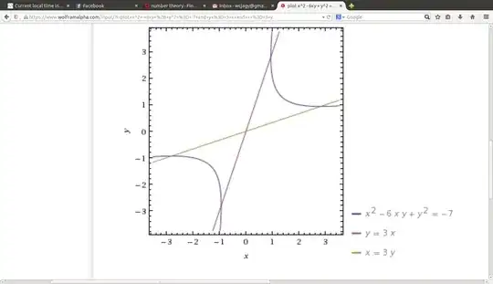

For (c=7) we get $(2,1), (1,2)$

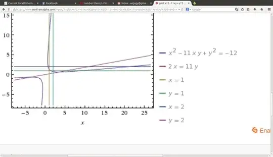

Let's see: for those who know calculus, the Hurwitz lines intersect this branch of the hyperbola in the minimum value of $x$ and the minimum value of $y.$ What happens when $c \geq 8?$
Well, as you can see in the picture, the branch passes through a point very near $(1,1)$ when $x=y,$ to be specific $$ x = y = \sqrt {\left(1 + \frac{3}{c-3} \right)}, $$ slightly larger then $1.$ However, as soon as $x=2,$ we find the $y$ value along the lower part smaller than $1,$ $$ y = (c-1) - \sqrt {c^2 - 3 c - 3} = \frac{c+4}{ (c-1) + \sqrt {c^2 - 3 c - 3}} $$

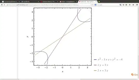

This thing has limit $1/2$ as $c \rightarrow \infty.$ $c=8, 0.91723,$ $c=9, 0.85857$ Not a coincidence: $c=7, x=2 \rightarrow y= 1, $ $c=4, x=2 \rightarrow y= 2. $
So that is the proof, for $c \geq 8$ there are no integer lattice points on the arc of the hyperbola within $$ 2 x \leq (c-1)y, $$ $$ 2 y \leq (c-1)x. $$ You can draw graphs for $c = 3,5,6,$ you will see that the arc of the hyperbola between the Hurwitz lines does not contain any lattice points.
