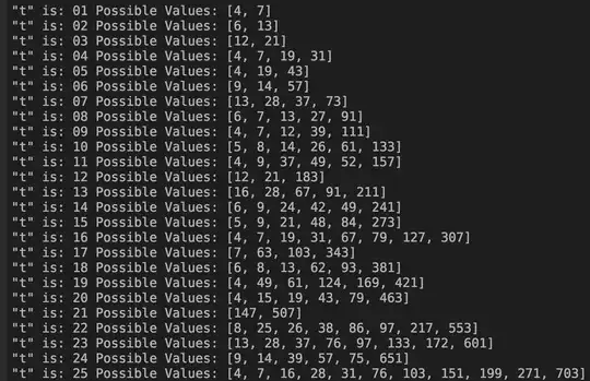

I focused on the different possible non-negative integer values for $c$ (for $x, y$ $\in$ $\Bbb{N}$). Then I run a 'tiny' computer search. Here's the result:
Showing possible values of c when t is 1-25

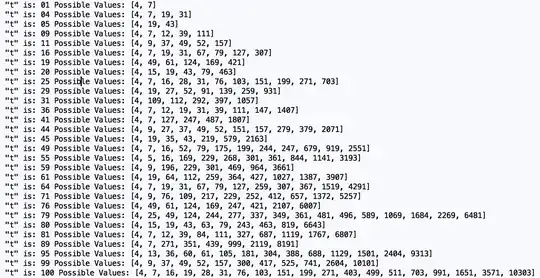

I observed that there is a lot of $4$s in the arrays, so I filtered them out:
So here is my result: when t is in the list below, $4$ is a possible value of $c$: [1, 4, 5, 9, 11, 16, 19, 20, 25, 29, 31, 36, 41, 44, 45, 49, 55, 59, 61, 64, 71, 76, 79, 80, 81, 89, 95, 99]
