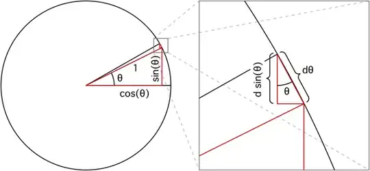

Consider the image from this "proof without words",
Derivative of $\sin(x)$
Asymptotically, the angle between the black radius and the red vertical line is complementary to both angles marked as $\theta$. Thus, asymptotically, those angles are equal, and the two red triangles are similar. Therefore, by similar triangles, $$ \frac{\mathrm{d}\sin(\theta)}{\mathrm{d}\theta}=\frac{\cos(\theta)}{1} $$ To get the derivative of $\cos(\theta)$, recall that $\cos(\theta)=\sin\left(\frac\pi2-\theta\right)$ and $\sin(\theta)=\cos\left(\frac\pi2-\theta\right)$. Then the Chain Rule says $$ \begin{align} \frac{\mathrm{d}}{\mathrm{d}\theta}\cos(\theta) &=\frac{\mathrm{d}}{\mathrm{d}\theta}\sin\left(\frac\pi2-\theta\right)\\ &=-\cos\left(\frac\pi2-\theta\right)\\[3pt] &=-\sin(\theta) \end{align} $$
robjohn
  • 353,833
    Of course the length $L$ of the line segment labelled $d\theta$ is only approximately equal to the number $d\theta$. But $L/d\theta$ converges to $1$ as $d\theta$ goes to $0$. – DanielWainfleet Oct 02 '15 at 17:29
    @user254665: Indeed. They are not equal, but they are asymptotically equal; that means precisely what you said: $$\lim_{\mathrm{d}\theta\to0}\frac{L}{\mathrm{d}\theta}=1$$ This is due to the fact that $$\lim_{x\to0}\frac{\sin(x)}{x}=1$$ as shown in this answer. – robjohn Oct 02 '15 at 19:25
    @robjohn To get the derivative of $\cos(\theta)$ just consider the other cathetus of the small triangle (which is $-d\cos(\theta)$). – A.Γ. Oct 03 '15 at 07:27
  • I am accepting this answer because I think it is useful to read this post first, since it is a bit more intuitive than the other answers. Even though a (big-list) usually has no accepted answer. – wythagoras Oct 08 '15 at 18:52
