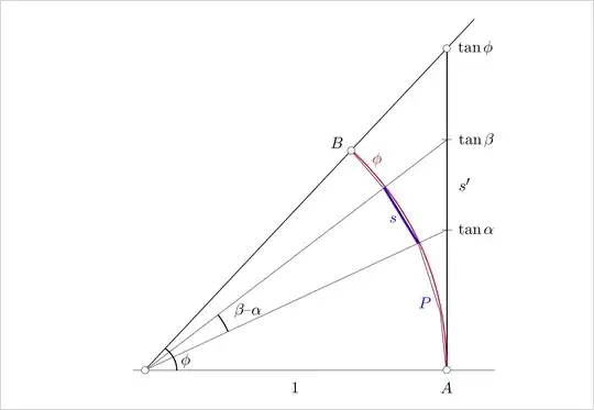

What is required here is not a proof of $\sin'=\cos$ without using $$\lim_{\phi\to0}{\sin\phi\over\phi}=1\tag{1}\ ,$$ but a proof of the basic limit $(1)$ using the "geometric definition" of sine provided by the OP. To this end we shall prove "geometrically" that $$\sin\phi<\phi\leq\tan\phi\qquad\left(0<\phi<{\pi\over2}\right)\ .\tag{2}$$ The inequalities $(2)$ imply $$\cos\phi\leq{\sin\phi\over\phi}<1\qquad\left(0<\phi<{\pi\over2}\right)\ ,$$ so that $(1)$ follows from $\lim_{\phi\to0}\cos\phi=1$ and the squeeze theorem.
Comparing segment length to arc length immediately shows that $$\sin\phi=2\sin{\phi\over2}\cos{\phi\over2}\leq2\sin{\phi\over2}<\phi\ .$$ In order to prove that $\phi\leq\tan\phi$ we somehow have to use how the length of curves is defined. I'm referring to the following figure. If $0\leq\alpha<\beta<{\pi\over2}$ then $$s'=\tan\beta-\tan\alpha={\sin(\beta-\alpha)\over\cos\beta\cos\alpha}=2\sin{\beta-\alpha\over2}\>{\cos{\beta-\alpha\over2}\over\cos\beta}\>{1\over\cos\alpha}>2\sin{\beta-\alpha\over2}=s\ .$$ It follows that the length $L_P$ of any polygonal approximation $P$ to the circular arc $AB$ is $\ <\tan\phi$, and this implies $$\phi:=\sup_PL_P\leq\tan\phi\ .$$

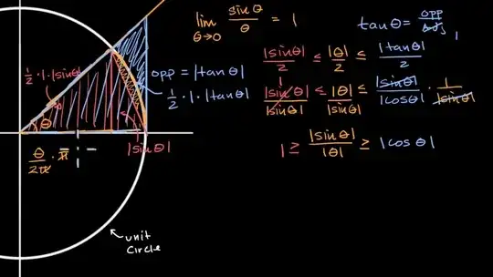

There is a very nice Khan Academy video on it. I won't get into too much detail but basically you construct the following enter image description here
Then you take limits of the inequality $$1\geq|\frac{\sin\theta}{\theta}|\geq|\cos\theta|$$
to get $$\lim_{\theta->0}1\geq|\frac{\sin\theta}{\theta}|\geq|\cos\theta|$$ $$1\geq|\frac{\sin\theta}{\theta}|\geq|1$$
and and therefore by the squeeze theorem we have $\lim_{\theta->0}\frac{\sin\theta}{\theta}=1$.
Having proved that for yourself you can then use the definition of a derivative that is $$f'(x)=\lim_{h->0}\frac{f(x+h)-f(x)}{h}$$ for $f(x)$ beeing $\cos(x)$. Hope that helps.
