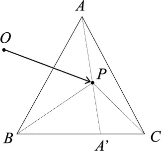

Let us use the following :
For a point $P$ inside $\triangle{ABC}$, $$\vec{OP}=\frac{[\triangle{PBC}]\cdot\vec{OA}+[\triangle{PCA}]\cdot\vec{OB}+[\triangle{PAB}]\cdot\vec{OC}}{[\triangle{ABC}]}\tag 1$$ where $[\triangle{PBC}]$ is the area of $\triangle{PBC}$.
Proof :
$\qquad\qquad\qquad\qquad$enter image description here
Since $$\vec{OA'}=\frac{A'C\cdot \vec{OB}+BA'\cdot\vec{OC}}{A'C+BA'}=\frac{[\triangle{PCA}]\cdot\vec{OB}+[\triangle{PAB}]\cdot\vec{OC}}{[\triangle{PCA}]+[\triangle{PAB}]},$$ we have $$\begin{align}\vec{OP}&=\frac{PA'\cdot\vec{OA}+AP\cdot\vec{OA'}}{PA'+AP}\\&=\frac{[\triangle{PBC}]\cdot\vec{OA}+([\triangle{PAB}]+[\triangle{PCA}])\cdot\vec{OA'}}{[\triangle{PBC}]+([\triangle{PAB}]+[\triangle{PCA}])}\\&=\frac{[\triangle{PBC}]\cdot\vec{OA}+[\triangle{PCA}]\cdot\vec{OB}+[\triangle{PAB}]\cdot\vec{OC}}{[\triangle{PBC}]+[\triangle{PCA}]+[\triangle{PAB}]}\\&=\frac{[\triangle{PBC}]\cdot\vec{OA}+[\triangle{PCA}]\cdot\vec{OB}+[\triangle{PAB}]\cdot\vec{OC}}{[\triangle{ABC}]}\end{align}$$ (By the way, $(1)$ holds for any point $P$ if we define the area of a "flipped" triangle as negative.)
