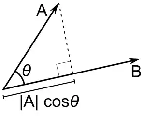

Dot product as projection
(Adapted from wikimedia commons: File:Dot Product.svg using Inkscape 0.91 to convert to PNG.)
The image illustrates the scalar projection of $\mathbf{A}$ onto $\mathbf{B}$, sometimes denoted $A_B$. You already know that, if $||\mathbf{B}||=1$, $\mathbf{A} \cdot \mathbf{B} = A_B$, and so for nonspecial $\mathbf{B}$, $$ \mathbf{A} \cdot \mathbf{B} = \mathbf{A} \cdot \hat{\mathbf{B}}||\mathbf{B}|| = A_B ||\mathbf{B}|| = ||\mathbf{A}|| \, ||\mathbf{B}|| \cos \theta$$ where $\hat{\mathbf{B}}$ denotes the unit vector along $\mathbf{B}$.
But what does this tell us? That $\mathbf{A} \cdot \mathbf{B}$ is maximized when $\theta$ is 90 degrees. In that case, the parallelogram $\mathbf{0}, \mathbf{A} , \mathbf{A} + \mathbf{B}, \mathbf{A} + \mathbf{B} - \mathbf{A} ({}=\mathbf{B})$ is a rectangle. Using the area formula for parallelograms (base times height), the area is maximized when $\mathbf{A}$ is all height. When $\theta$ is not a right angle, the area is less, decreasing to zero as $\mathbf{A}$ and $\mathbf{B}$ become (anti-)parallel.

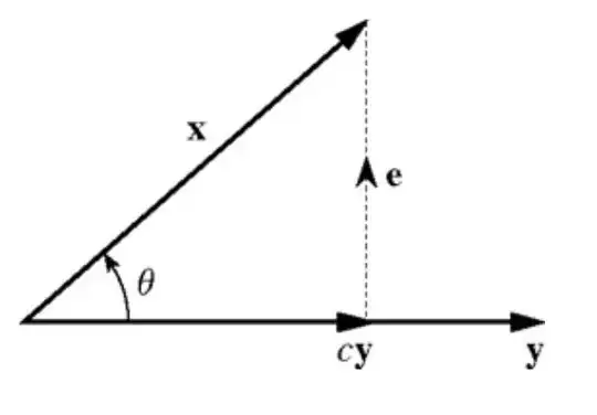

@Mehrdad
I had the same question as you have expressed:
I feel like the hard part is understanding why dot product has anything to do with projection in the first place. Why does the sum of a componentwise product tell you something about the vectors' projection?
After some thinking, I come up with the following reasoning, not sure if it make sense to you.
  1. In Section 6.5-1 of Lathi’s Linear Systems and Signals, 2nd, projection of $\mathbf{x}$ along $\mathbf{y}$ can be interpreted as a way to minimize the "error" $\mathbf{e}$, when $\mathbf{x}$ is expressed as $\mathbf{x}=c\mathbf{y}+\mathbf{e}$, where $c\mathbf{y}$ is the component of $\mathbf{a}$ in the direction of $\mathbf{b}$, and $\mathbf{e}$ is the "error" vector, which has the minimum length when it's perpendicular to $\mathbf{b}$.
  2. Btw: the "error" vector gives hints on how much $\mathbf{x}$ is differ from $c\mathbf{y}$. In this sense, projection is a way to find similarities of two vectors, and this may explain why correlation is calculated exactly in the same way as dot product.
  3. Now the question can be rephrased as: why product has anything to do with correlation/similarity? Let's take plain numbers (not vectors) for now. To find difference between two numbers $a$ and $b$, we do subtraction $a-b$, which can be either positive or negative. Most of the time people only cares about the absolute value of the difference $|a-b|$, but $|a-b|$ is not convenient in mathematical manipulation. So people square the difference, $(a-b)^2$...this is where the product comes in. The formula $(a-b)^2=a^2+b^2-2ab$ suggests that the product $ab$ has its place as a measure of the difference or similarity between $a$ and $b$.
