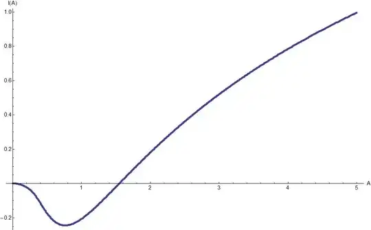

Consider a following integral: \begin{equation} {\mathcal I}(A) := \int\limits_{\mathbb R} \log\left(1+ A \xi\right) \cdot \frac{\exp(-\frac{\xi^2}{2})}{\sqrt{2 \pi}} d\xi \end{equation} By using the trick $\left. d \xi^a/d a \right|_{a=0} = \log(\xi)$ then by substituting for $\xi^2/2$ and then by expanding the resulting power-law term into a binomial expansion and integrating the result term by term using the definition of the Gamma function I have shown that: \begin{equation} {\mathcal I}(A) = \log(\frac{A}{\sqrt{2}})+ \imath \frac{\pi}{2} - \frac{\gamma}{2} + \frac{1}{2 A^2} F_{2,2}\left[\begin{array}{rr} 1 & 1 \\ 2 & 3/2\end{array};-\frac{1}{2 A^2}\right]- \imath \frac{\sqrt{\pi}}{\sqrt{2} A} F_{1,1}\left[\begin{array}{r} \frac{1}{2} \\ \frac{3}{2} \end{array};-\frac{1}{2 A^2}\right] \end{equation} The real part of the function in question is plotted below: enter image description here
It clearly behaves as a parabola ${\mathcal I}(A) \simeq -A^2/2$ for $A \rightarrow 0$ and as a logarithm ${\mathcal I}(A) \simeq \log(A)$ for $A\rightarrow \infty$.
