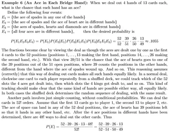

Rather than trying to rephrase, I think a great choice is the explanation by F. Scholz here:
    (Clearly "ace of space" is a typo for ace of spades, $A \spadesuit$!) – Benjamin Dickman Jul 01 '15 at 05:05
    I really like the first method given here, because it also leads to the rough approximation $\frac34\times\frac12\times\frac14=\frac{3}{32}=.09375$, which we know is low, because $\frac{39}{51}>\frac34$, etc. – G Tony Jacobs Jul 01 '15 at 05:22
    @GTonyJacobs Agreed; see, in particular, Chapter 4 Problem 21 here in Grinstead and Snell's Introduction to Probability. – Benjamin Dickman Jul 01 '15 at 05:33
