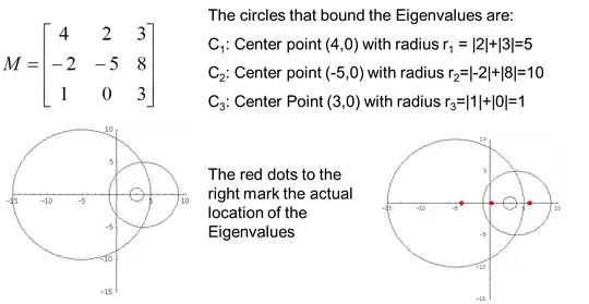

Let's try an example from this html/powerpoint here:
Example

You can draw the circles/discs associated with these inequalities fairly easily.
