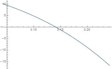

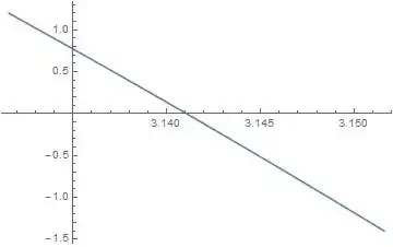

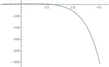

Probably useless for the solution, but nevertheless interesting graphs of $(x+1)^{x+1}-x^{x+2}$:
Using computer:
$(\pi+1)^{\pi+1} = 359.796$
$\pi^{\pi+2} = 359.867$
