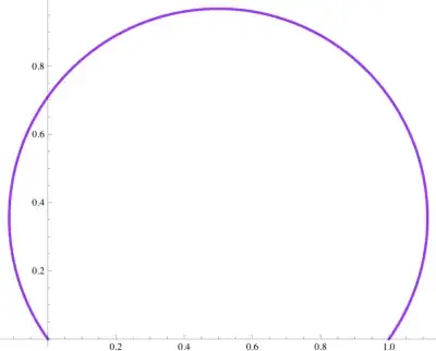

Since the length of the chord of the circle we want is $1$, we have $$ 2r\sin\left(\frac\theta2\right)=1\tag{7} $$ Since the area cut off by this chord is $1$, we have $$ r^2\left[\frac\theta2-\sin\left(\frac\theta2\right)\cos\left(\frac\theta2\right)\right]=1\tag{8} $$ Square $(7)$ to get $$ 2r^2(1-\cos(\theta))=1\tag{9} $$ and rewrite $(8)$ to get $$ \frac12r^2(\theta-\sin(\theta))=1\tag{10} $$ Solve $4(1-\cos(\theta))=\theta-\sin(\theta)$ to get $$ \theta=4.3760724130128873845\tag{11} $$ and then $(7)$ gives $$ r=0.61313651252231835636\tag{12} $$ This would lead to a minimum length of $$ L=r\theta=2.6831297778598481320\tag{13} $$
Problem
Unfortunately, since $\theta\gt\pi$, the minimizing curve is an arc that cannot be represented by a function.

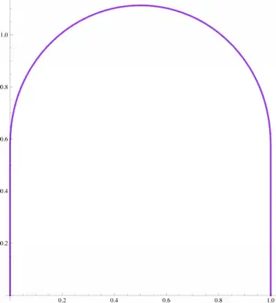

The minimizing curve that is closest to the graph of a function is the curve that joins $(0,0)$ and $(1,0)$ to the endpoints of $$ y=1-\frac\pi8+\sqrt{x-x^2}\tag{14} $$
which has a length of $$ 2+\frac\pi4=2.7853981633974483096\tag{15} $$ However, this curve is not the graph of a function.

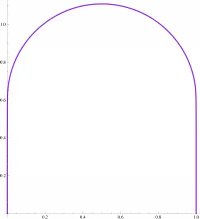

A Sequence of Approximations
$$ f_n(x)=\frac1{c_n}\left(1-\frac\pi8+\sqrt{x-x^2}\right)\left(x-x^2\right)^{1/n}\tag{16} $$ where $$ c_n=\left(1-\frac\pi8\right)\frac{\Gamma\left(1+\frac1n\right)^2}{\Gamma\left(2+\frac2n\right)}+\frac{\Gamma\left(\frac32+\frac1n\right)^2}{\Gamma\left(3+\frac2n\right)}\tag{17} $$ As $n\to\infty$, the length of $f_n$ approaches $2+\frac\pi4$.
At $n=100$, we get a length of $L=2.7857313936$, less than $\frac1{3000}$ above the minimum:
At $n=1000$, we get a length of $L=2.7854017568$, less than $\frac1{250000}$ above the minimum.

The absolute least value you can get is a rectangle topped by a half circle (the circle has the best area to arc length ratio of any shape) with a total arc length of $2 \big(1 - \frac{\pi}{8}\big) + \frac{\pi}{2} \approx 2.78539$. If you use Fourier approximation, you can come arbitrarily close to this limit. (I assume the fun of this challenge is to find an arbitrarily "low-term" function.)

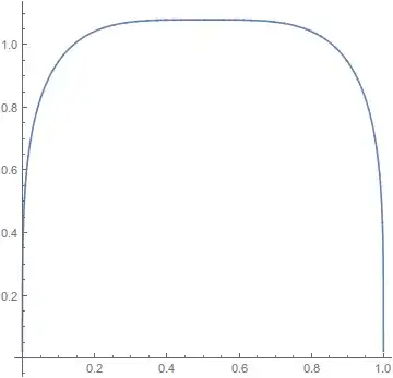

Without a deeper thought or analysis, I thought it could be fun to look at parts of (translated) superellipses, and maybe make top 10 with it. And indeed it worked.
Thus, I defined $g(x,n)=(1-|x|^n)^{1/n}$, and then $$ f(x,n)=g(2x-1,n) = (1-|2x-1|^n)^{1/n}. $$ Normalizing $c_n=1/\int_0^1 f(x,n)\,dx$ and then calculating the length of $c_n f(x,n)$, it looked like the optimum choice was $n=4$.
The constant $c_4\approx 1.07871$. The arc length of $$ 1.07871(1-|2x-1|^4)^{1/4} $$ was numerically calculated to be $$ 2.81108, $$ which I leave as my contribution.
The graph of $c_4f(x,4)$ is shown below:

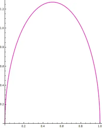

An easy approach is to simply construct an ellipse with its upper half satisfying the above conditions.
An ellipse is defined via $2$ numbers $a$ and $b$ which are each the half of the major and minor axis of the ellipse.
ellipse
Then all points $(x,y)$ which suffice the following equation are on the ellipse:
$$ \frac{x^2}{a^2} + \frac{y^2}{b^2} = 1 $$
Or to get the upper half of the eclipse as a function:
$$ y = b \, \sqrt{\left(1 - \frac{x^2}{a^2}\right) } $$
The area $A$ of the complete ellipse is given via $A = \pi\,a\,b$ and therefore our first condition translates to:
$$ \frac{1}{2}\,\pi\,a\,b = 1$$
Also, as we want that $f(0) = 0 = f(1)$, we have:
$$ 2\,a = 1 $$
That already gives us
$$ a = \frac{1}{2} \\ b = \frac{4}{\pi} $$
and therefore an ellipse with the correct size. However, this results in an ellipse which intersects the $x$-Axis at $x_1=-0.5$ and $x_2=0.5$. To meet our conditions, we move the ellipse $0.5$ to the right and get:
$$ y = \frac{4}{\pi} \, \sqrt{1 - 4\,(x-0.5)^2 }\tag{$\dagger$} $$
Now we simply let Wolfram Alpha do the computation for the arc length. The result is $$ 2.919463, $$ and the graph in $(\dagger)$ appears below:

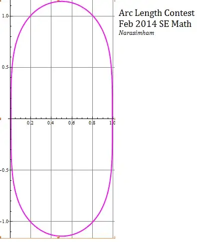

I would not be content without a proper derivation of Dido's problem of variational calculus with constraints of moving boundary considered. When properly done I expect the curvature would be proportional to the square or cube or some other function of $y$-coordinate.
For time being proceeding purely on squared variation hypothesis for curvature as:
$$ k_g = - y^2 / a^3, $$
LoopMinLenMaxArea
where $a$ is a constant, I obtained the above stationary closed loop.
Numerically adjusting constant $a$ and initial $y_i (a = 0.7925, y_i = 1.143)$, it is close to the results listed here. The constants are such that perturbation causes the loops to get either progressive or regressive. The area is not very accurately $1.0$ ($\sim 0.98$ only) satisfied, length is approximately $2.78$. Improvement of numerical accuracy possible, but proper theoretical basis is necessary. In this hypothetical case, hyper-Elliptic Integrals are involved.
