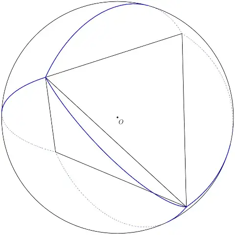

For what it's worth at this late date (and not having read the paper): I'd guess the author means "radial projection from the origin", which sends each point $x$ on the tetrahedron to its normalization $x/\|x\|$:
Faces of a tetrahedron projected onto a sphere
