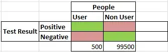

The answers here are good, but if you're like me, you learn better with visual aids and actual numbers. I have one for Bayes's Theorem using the same testing idea. Here's the setup:
  • You have a population of 100,000 people
  • 0.5% of this population use a drug
  • We have a test that tells us with 99% accuracy if a person is or is not a drug user
  • You tested positive for this drug. What are the odds that you're a user given this information?
Let's set this up in a simple grid:
In the columns, I show counts of users and non-users. We are told that 0.5% of the population of 100,000 use this drug, so there are 500 users and 99,500 non-users.
In the rows, I show counts of test results. I will fill in these values in a moment.
I've highlighted cells inside the table in a certain way:
  • Green cells are accurate test results. If a person is a user and the test result is positive, the test is accurate and the cell is green. Likewise, if a person is not a user and the test result is negative, the test is accurate and the cell is green.
  • Red cells are inaccurate test results. If a person is a user but the test is negative, this is a false-negative and the cell is red. Likewise, if a person is not a user but the test is positive, this is a false-positive and the cell is red.

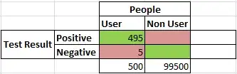

Let's start filling in the table. Given that we have 500 users, how many positive and negative test results will we have among this subset of the population? We're told the test is 99% accurate, so that's 495 positive results and 5 false-negatives:

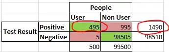

Following the same process for the non-users: given that we have 99,500 non-users, how many positive and negative results will we have among this subset of the population? Again, the test is 99% accurate, so that's 98,505 negative results and 995 false-positives.
Time to analyze the results. We're told that you tested positive for the drug, so let's throw out the results pertaining to negative test results and look at only the "Positive" row in the grid. 1,490 people tested positive for the drug, of which 495 actually are users, and 995 are false-positives. From here it's easy, the probability that you're actually a user given that you're in the "Positive" row is $\frac{495}{1490} = 33.2\%$
Turning this into a formula:
$P(Drug User Given Positive Result) = \frac{P(DrugUser)*N*TestAccuracy}{P(DrugUser)*N*TestAccuracy + P(NotDrugUser)*N*(1 - TestAccuracy)}$
This is exactly the formula I calculated to get 33.2%. Here, N is the 100,000 number that I made up. N cancels out and thus my 100,000 is extraneous information, but I thought it'd be helpful to include it.
With this grid I hope it's clear why, even with a test accuracy so high, your chances of actually being a drug user given a positive test result are so much lower. The number of false-positives is large enough to skew the naive intuition of the result.

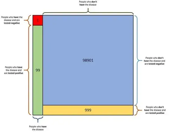

This Jan 10 2020 article on Medium can explain with just one picture!
  • A rare disease infects only $1/1000$ people.
  • Tests identify the disease with 99% accuracy.
If there are 100,000 people, 100 people who have the rare disease and the rest 99,900 don’t have it. If these 100 diseased people get tested, $\color{green}{99}$ would test positive and $\color{red}{1}$ test negative. But what we generally overlook is that if the 99,900 healthy get tested, 1% of those (that is $\color{#e68a00}{999}$) will test false positive.
Now, if you test positive, for you to have the disease, you must be $1$ of the $\color{green}{99}$ diseased people who tested positive. The total number of persons who tested positive is $\color{green}{99}+\color{#e68a00}{999}$. So the probability that you have the disease when you tested positive is $\dfrac{\color{green}{99}}{\color{green}{99}+\color{#e68a00}{999}} = 0.0901$.
