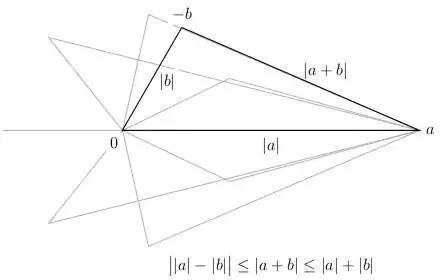

Suppose you supply two arbitrary real numbers $a$ and $b$. Let's construct a "triangle" (on the number line) whose vertices are $0$, $a$, and $-b$. (We're free to choose vertices as we like; pick $-b$ instead of $b$ for reasons to be explained in a moment.)
Since the distance between real number $x$ and $y$ is $|x - y|$, the sides of our "triangle" have lengths $$ |a - 0| = |a|,\qquad |-b - 0| = |-b| = |b|,\qquad |a - (-b)| = |a + b|. $$ (Now you know why we picked $-b$: To get $a + b$ inside the absolute value.:)
Two sides of our triangle have length $|a|$ and $|b|$. It's reasonable to ask: Based on this information alone, how long can the third side be?
It should be fairly clear geometrically that:
  • The third side cannot exceed $|a| + |b|$, the sum of the lengths of the known sides. In symbols, $$ |a + b| \leq |a| + |b|. $$ This is the triangle inequality.
  • The third side cannot be shorter than the distance between the real numbers $|a|$ and $|b|$. In symbols $$ |a + b| \geq \bigl||a| - |b|\bigr|. $$ This is the reverse triangle inequality.
In your particular example, if two sides of a triangle have length $2$ and $5$, then the third side cannot be shorter than $|2 - 5| = |-3| = 3$, and cannot be longer than $|2 + 5| = |7| = 7$. (On the number line, the sides of a "triangle" are parallel, so the third side is actually equal either to $3$ or to $7$. However, similar-looking inequalities hold for distance in the plane, or in space, or in higher-dimensional spaces. In these spaces, the sides of a triangle need not be parallel. In the plane, the third side of your triangle could have any length between $3$ and $7$.)
