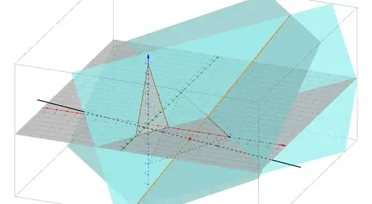

I get $(3.5,1.5,-1.5)^T$ as well.
The yellow line is the intersection of the two planes, the big red dot the intersection with the given line (black).
$$ E_1: 3x - 2y + z = 6 \wedge E_2: x + y - 2z = 8 $$ Solving for $z$ gives $$ z = 6 - 3x + 2y = -4 + x/2 + y/2 \\ 10 = 7/2 x - 3/2 y \iff y = 7/3 x - 20/3 $$ E.g.choosing $x=3$ and $x=4$ then $a = (3, 1/3, 6 - 9 + 2/3)^T = (3, 1/3, -7/3)^T$ and $b = (4, 8/3, 6-12+16/3)^T = (4, 8/3, -2/3)^T$ are part of the intersection $E_1 \cap E_2$.
From this we generate the line \begin{align} g &: (3, 1/3,-7/3)^T + ((4, 8/3,-2/3)^T - (3, 1/3,-7/3)^T) s \\ &= (3, 1/3,-7/3)^T + (1, 7/3, 5/3)^T s \end{align} and intersect it with the given line $$ f: (1,1,-1)^T + (5,1,-1)^T t $$ $g(s) = f(t)$, which gives the system: $$ \left( \begin{matrix} 1 & -5 \\ 7/3 & -1 \\ 5/3 & 1 \end{matrix} \right) \left( \begin{matrix} s \\ t \end{matrix} \right) = \left( \begin{matrix} -2 \\ 2/3 \\ 4/3 \end{matrix} \right) $$ This has the solution $(s, t) = (1/2, 1/2)$.
Using for example $t=1/2$ with $f$, we get $$ P = (3.5, 1.5, -1.5)^T $$
