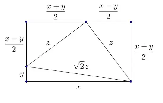

This picture shows the correspondence between Pythagorean triangles and $x^2 + y^2 = 2z^2$ triangles. Note that, if $x^2 + y^2 = 2z^2, $ then $x$ and $y$ are either both even or both odd. In either case $\frac{x+y}{2}$ and $\frac{x-y}{2}$ are both integers.
two to one
