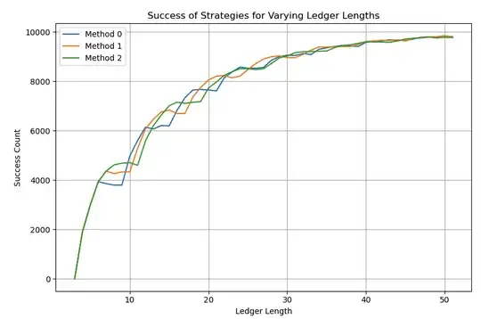

So for round lengths of [6, 7, 8] I found these results: Graph of y strategy successes over x rounds

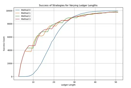

Adding the default "counter" strategy as Method 0 for comparison: Graph of escapes over rounds
There are tradeoffs with round lengths on the try and test strategy, but it significantly outperforms counter until round lengths of 28 or so.
